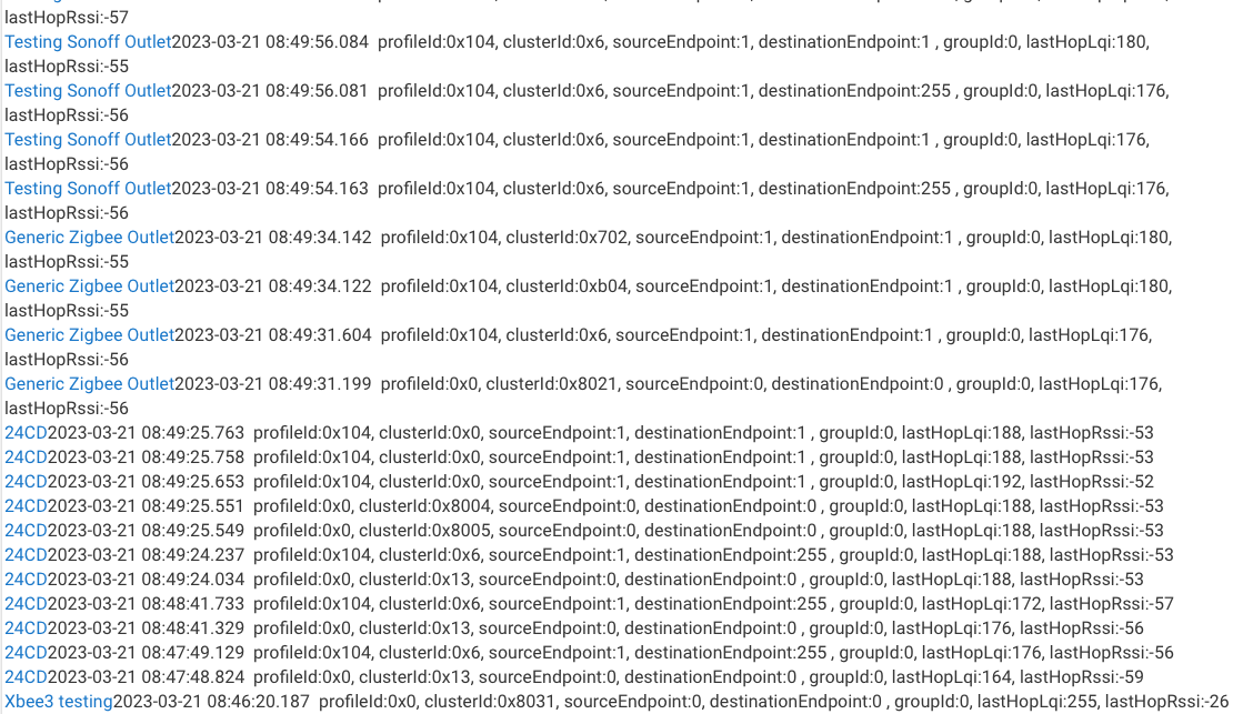

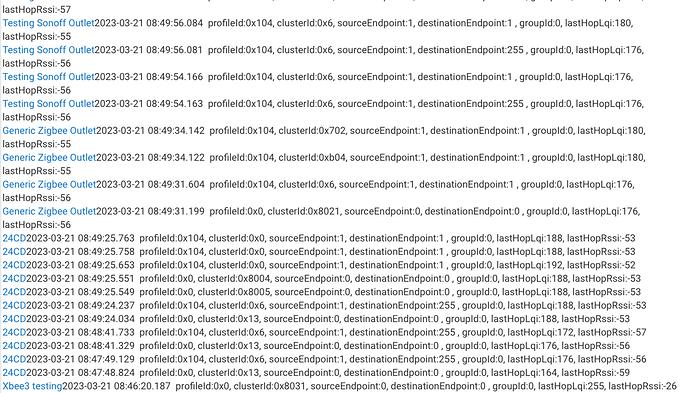

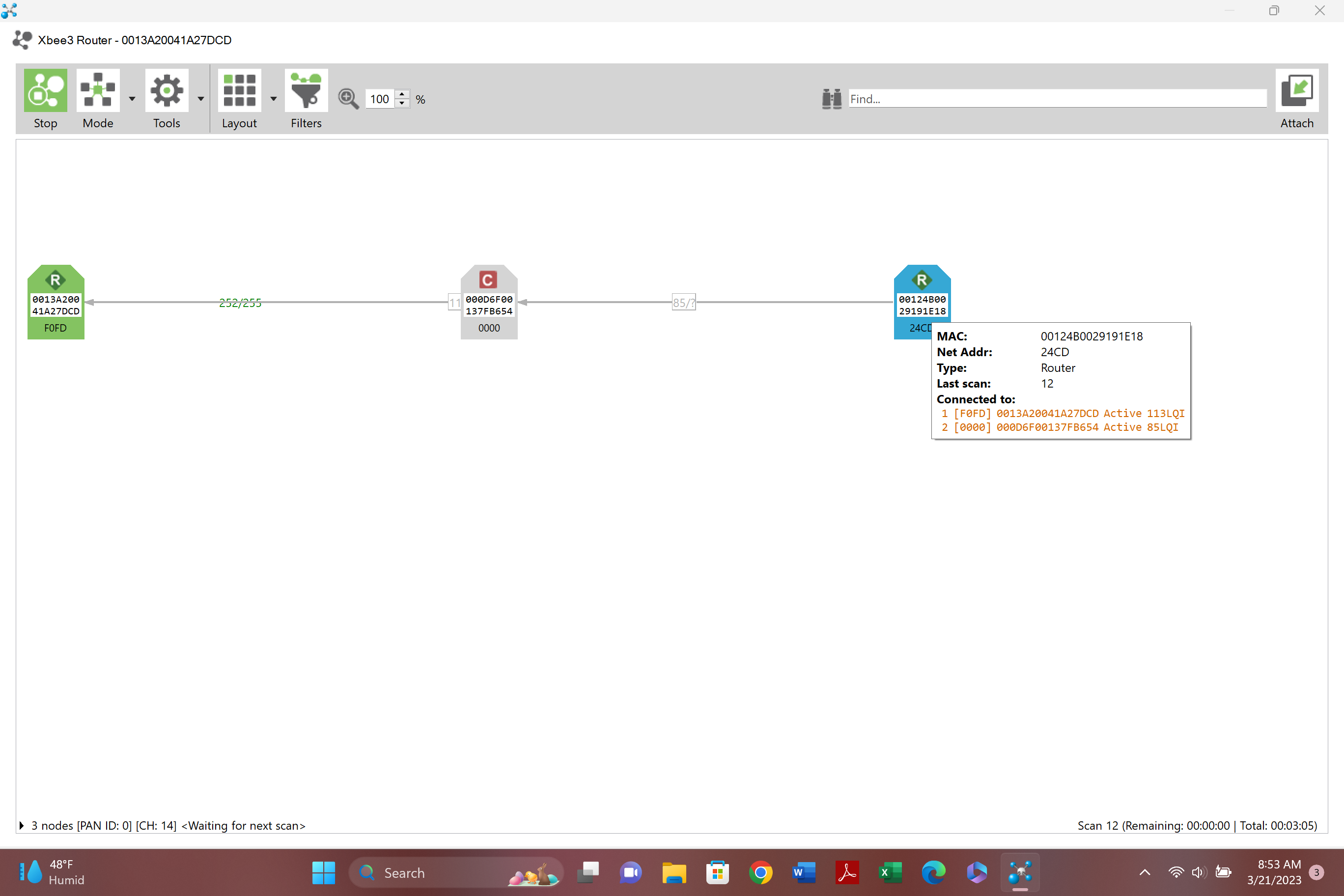

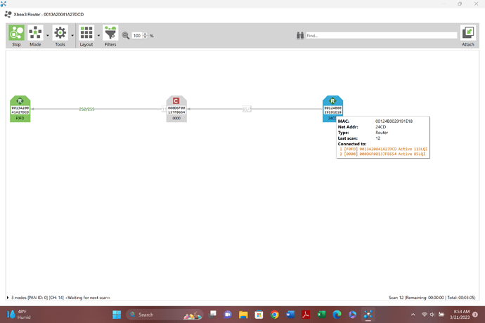

Lqi On the C8 is actually more accurate on the signal going to the router than the C5. I can see a lot more of what's going on by using Xbee's and things really don't look good signal wise for router signals coming back to the C8. Remember there's a route going to the repeaters and a route coming back. I just don't get why the C5/C7 can handle these weaker signals better from not so great repeaters.
Here's an example of a sonoff Outlet S31 zb I think.
This is how the C8 see's the signal to the Sonoff The Sonoff starts out under 200 these devices are in the same room about 10 feet max away from the C8 Xbee 3 devices nice signal both ways

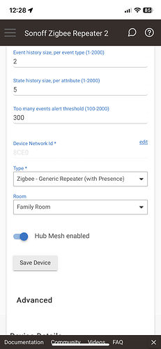

Also, I’m using the “Zigbee Repeater with Presence” driver on HPM set to bind (xbee setting). I had issues with them occasionally dropping off of my C-5s and set up a rule to notify me if it changed to “not present”. The driver will also attempt to reconnect the device if it doesn’t respond to the ping.

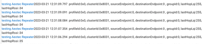

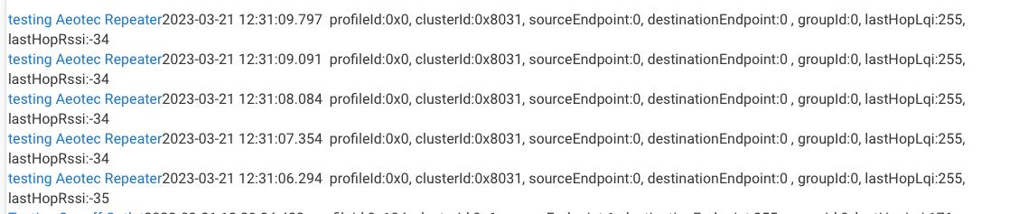

Aeotec Zigbee repeaters seem good for the people that don't want to mess around with Flashing the Sonoff dongle. I'm sure the Sonoff dongles are good so no point in testing just going to Flash them and start using.
What the C8 reports
