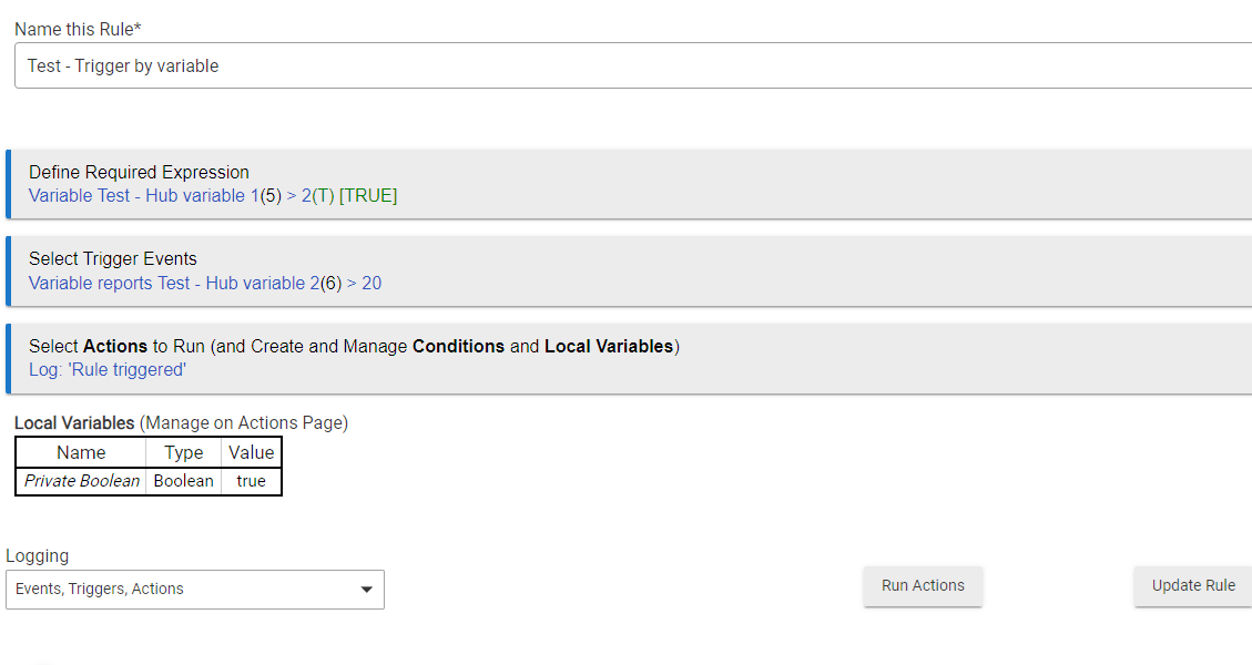

@bravenel I have been able to reproduce @mluck's issue on 2.4.0.151 (C8) but not on 2.3.9.200 (C7).
Steps to reproduce:

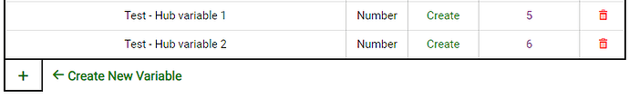

  1. Create new hub variables of type number:
    "Test - Hub variable 1" = 5
    "Test - Hub variable 2" = 6

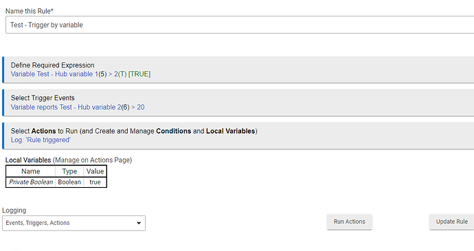

  2. Create new RM 5.1 rule and name it.
  3. Enable Required Expression and set it to Variable "Test - Hub variable 1" > 2
  4. Create the trigger and set it to Variable "Test - Hub variable 2" > 20
  5. Create a logging action just to have an action in the rule.
  6. Set logging to Events, Triggers, Actions
  7. Click Install Rule and then Done for good measure and then go back into the rule

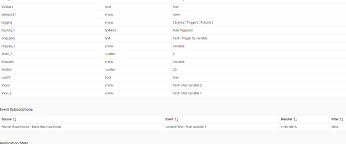

Of note at this stage is that Event Subscriptions for the rule only have "Test - Hub variable 1" listed:

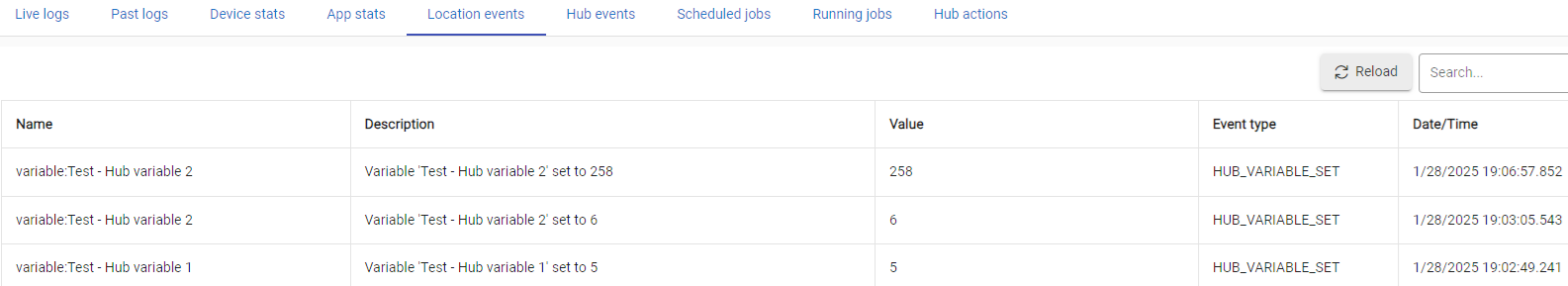

  1. Change the variable "Test - Hub variable 2" to a value larger than the trigger value (which is >20). In this case I set it to 258, which should trigger then rule since the required expression is already True. The Location Events log confirms that the variable was changed:
The two events at 19:02 and 19:03 are from when the variables were created.

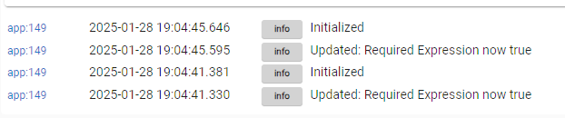

Logs from the RM rule show nothing. The only events in the logs are from when I first clicked the "Install rule" button and then the "Done" button.
Still only the one variable in the event subscriptions of the rule is "Test - Hub variable 1"
I've tried setting the two variables to different values both under and over the conditions in the trigger and the Required Expression and hit "Update rule" and "Done" on the rule several times during this testing, but nothing has managed to get the second variable into the event subscriptions (which I assume is a requirement for the rule to trigger) or get the rule to run the actions.
Yeah, there was a new bug introduced with a recent bug fix concerning variables in Required Expressions, and evidently it is not creating the right Event Subscriptions in this case. Fix will be forthcoming.
