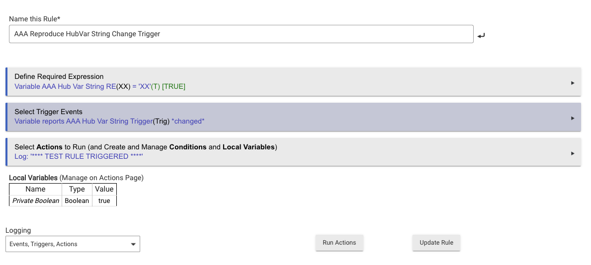

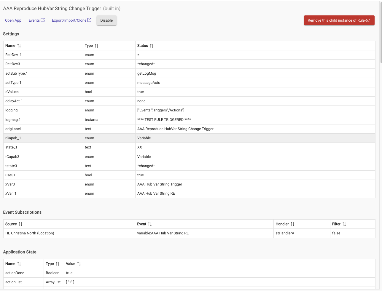

@bravenel, I'm inferring this bug squash hasn't been released yet since I haven't seen it in the release notes. Assuming this is true, wanted to let you know that I'm seeing a variant of the bug on C7 2.4.0.151 even when two different variables are used across RE and Trigger. See the below example--it doesn't trigger as expected. I've been able to reproduce, but oddly not on my C8. Hope this helps tracking it down.
Please post the Event Subscriptions from the App status page.

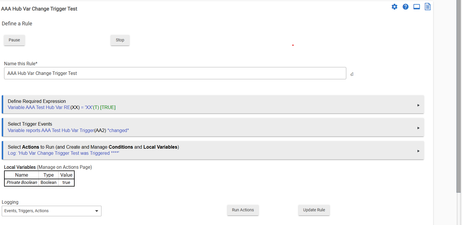

I made a rule just like yours, and it works as expected.

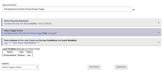

Hmm you have me doubting myself, so I rebuilt the same rule from scratch for a third time with new hubvars and it still doesn't trigger. Below is my most recent attempt on a C7 along with the Event Subscriptions. FWIW if I do this same thing on my Dev hub (C8), it works as expected.

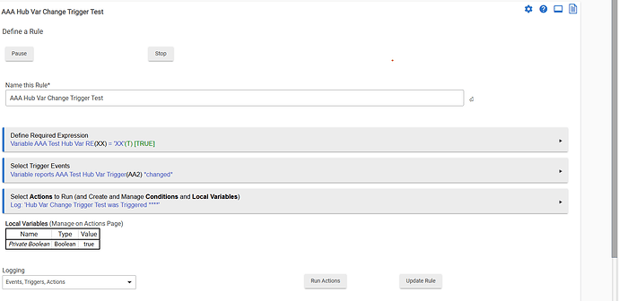

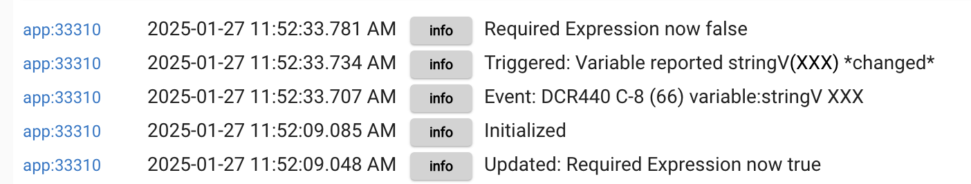

This is what mine looked like:

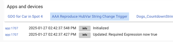

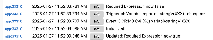

After clearing log, clicked "Update Rule", then manually changed value of trigger variable. Here's the resulting log--not much to go on.
Screenshot 2025-01-27 at 2.43.17 PM
So, no variable events? Did you change the variable value?
Correct. After updating rule, I went to Settings/Hub Variables, clicked on current value of variable, and changed it to another value. Rule not triggered.
Well, until you are getting events from Hub Variables, nothing like your rule will work. I don't know what's going on with your hub. You should probably restore a backup. Make a simpler rule with no Required Expression, and see if you get Hub Variable events or not.

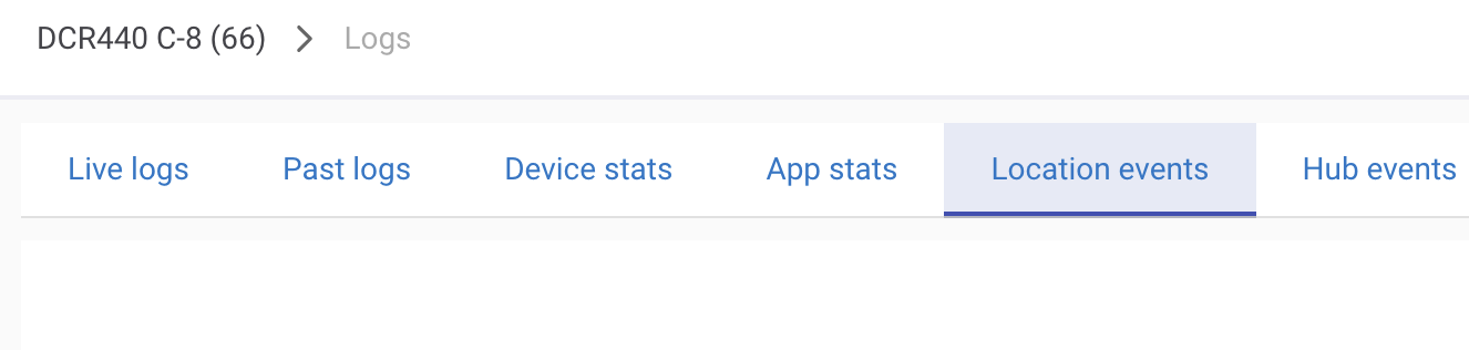

Look at Location Events. Hub Variable changes are there:
Ok thanks. Now I know where to look. Will do some fiddling and revert.
Turns out the hubvar change does show up under Location Events, but still no RM trigger. When I removed the RE (that had showed as TRUE), however, the hubvar change did trigger the rule successfully.
