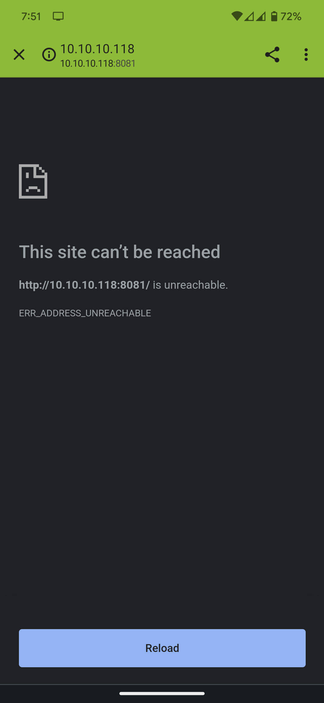

This is telling. Assume hurry was supposed to be hub. When that happens, can you access the Diagnostic Tool? If yes, then you are dealing with a database issue. If you can't access the Diagnostic Tool, then look into network issues.
Froze today, no luck with diagnostic tool. I'll be looking at logs and going to start disabling one rule at a time and see if it helps.

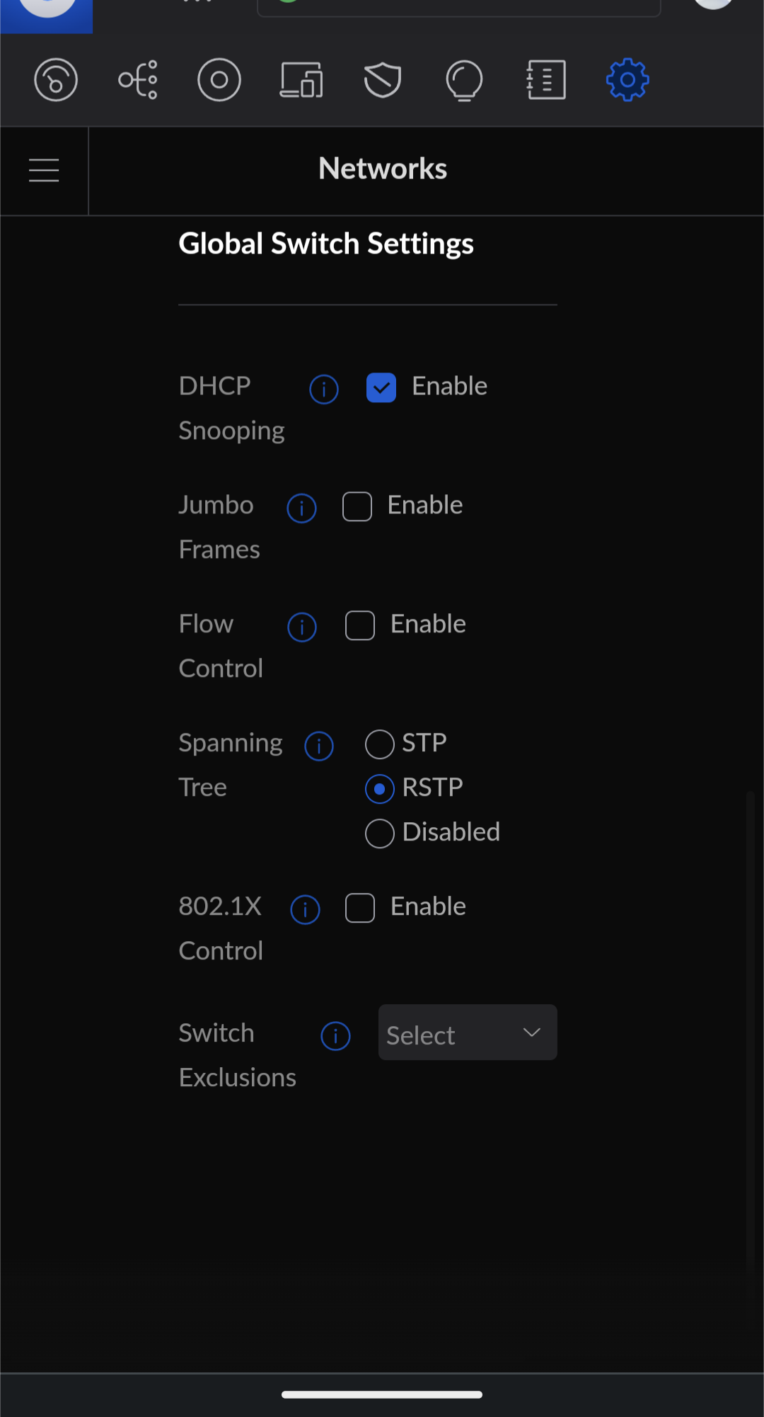

Did you by chance upgrade or change settings on any networking equipment recently? If jumbo frames is enabled anywhere on the LAN and multicast JF packets hit the hub it can cause it to crash the networking like this where nothing is accessible.
Do you have jumbo frames anywhere on your network?
No jumbo frames
Have you EVER had jumbo frames enabled? We have heard before that its off and then they come back weeks later and say they found it, and it was jumbo frames on a single device.
Besides that, I would try taking a backup and then restore it right away (the restore also does a soft reset). Hub will boot back up same as it was but it cleans the database.
I have unifi equipment and I have the global setting set for the other two switches connected to this router and it's always been off. I'll do a backup and restore today after work and follow up.
Check NAS and any servers as well, make sure it is off. Could be one client machine sending out JF multicast.
None of the switches are cut-through are they?
I will double check. Everything else since the c8 upgrade has been the same, qnap nas, server etc but an upgrade could've changed settings. Just going to let Wireshark run on my unifi through ssh to see if I can find something quicker through there
