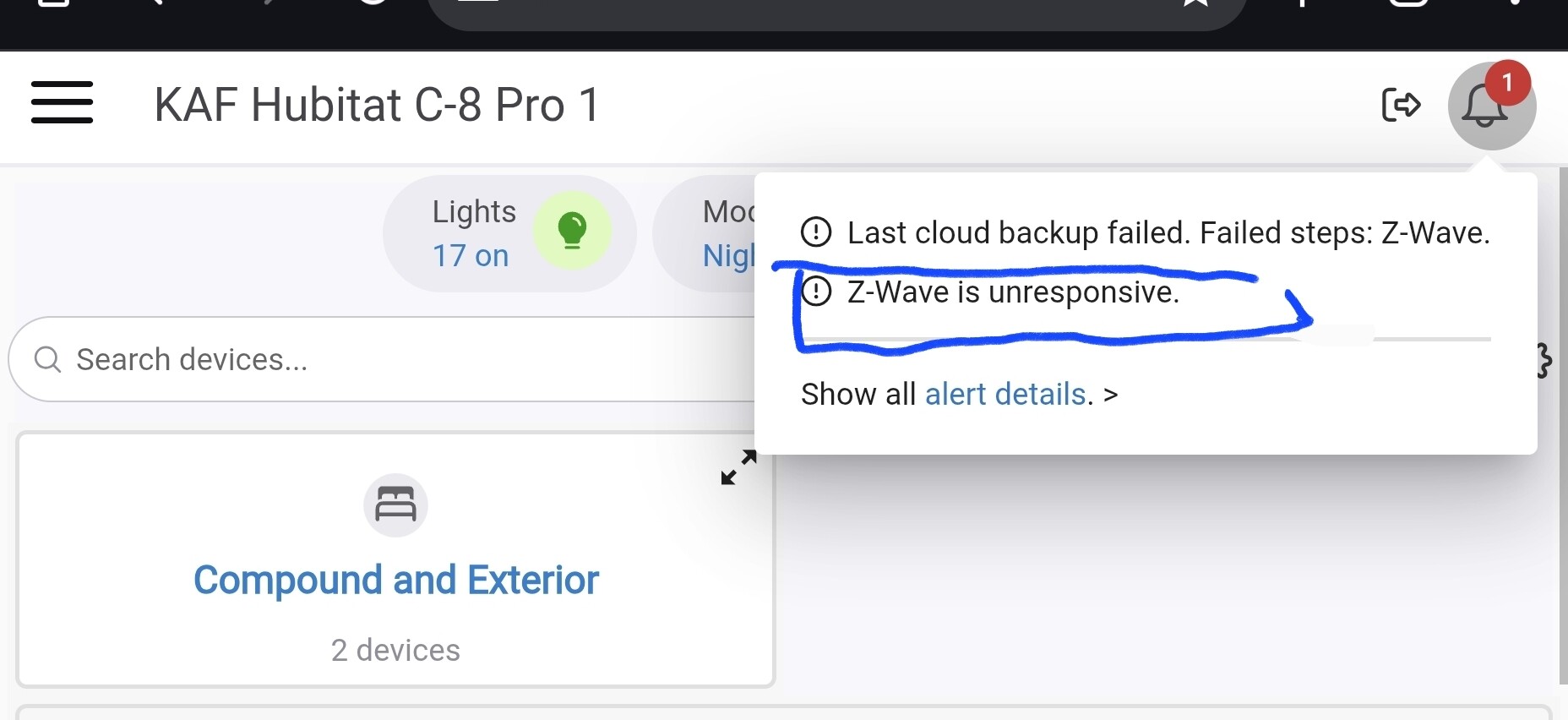

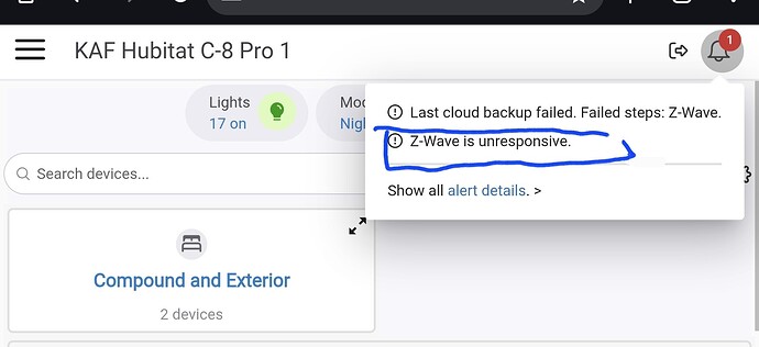

My c8 pro zwave was working fine until I decided to swith to zwave js. I'm on platform vs 2.4.1.177.
Before switching, I had a little over 40 zwave devices paired and the mesh was pretty strong and highly responsive and fast. Reading about zwave js, I switched to it. Prior to that, the zwave topology was blue majority (more than 90%)..and it was all good. But immediately after switching to js, all the paired devices became unresponsive. I checked the zwave topology and it was all red. The few devices that would respond would take minutes after turning them on or off. I decided to switch back to the standard zwave stack and nothing changed... Then I saw a zwave firmware update available option, tried to update the firmware, no luck, even the firmware will not update, stuck on "Getting device versions" and nothing happens.
I have tried soft resetting the hub and restoring my old backup, no luck.

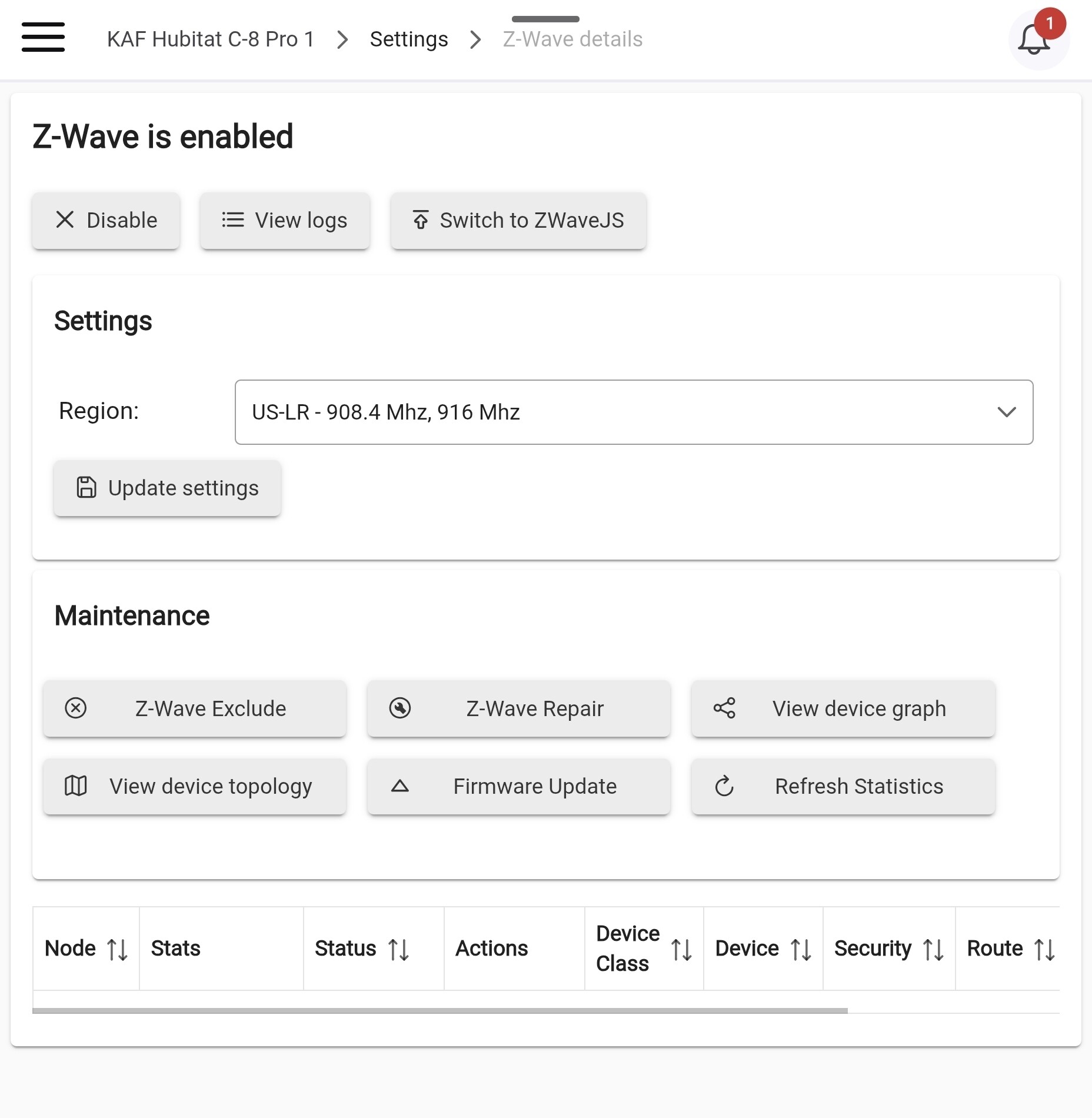

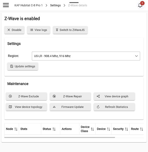

Now what I see is that when I open the zwave menu, I see no devices installed there, but when I go to devices, I see the zwave paired devices still showing there.
I'm stuck at this stage. I've tried re-pairing all the devices, excluding them don't work, including them don't also work.
Please assist. Many thanks in advance.

First be sure you are back on ZIP by checking the button on the zwave details page (should have option to switch to Zwave JS).

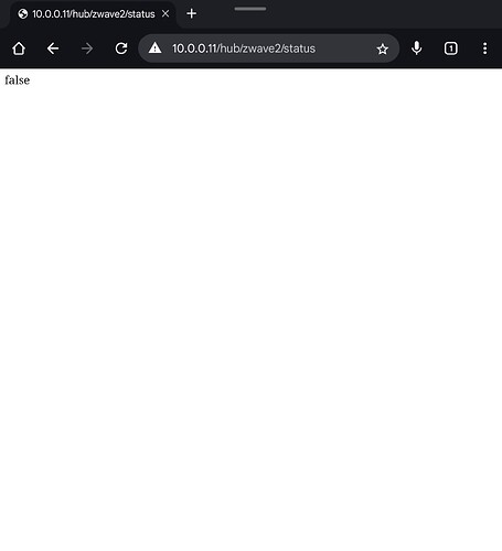

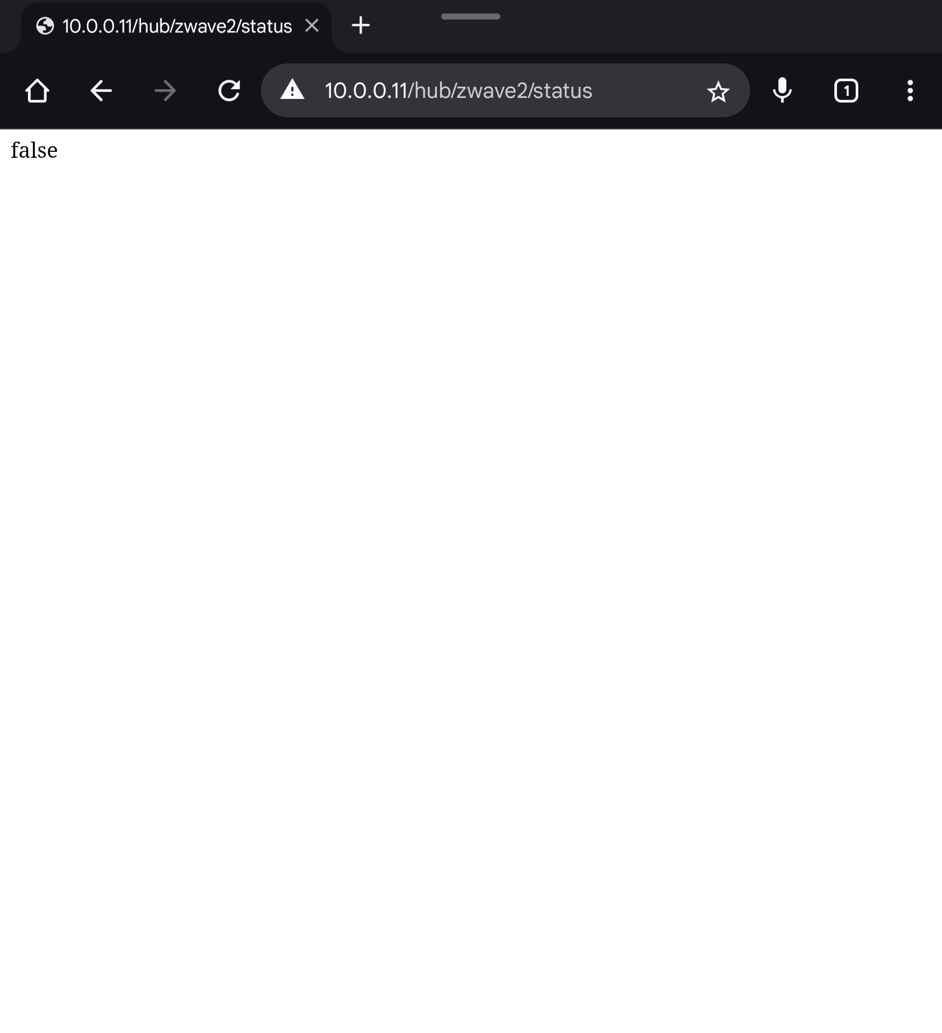

You can verify with this endpoint (may not work when radio is offline though)
Use in your browser with the IP for your hub.
http://HUB.IP/hub/zwave2/status
Should say false when run

Yes, I restored a cloud backup after I raised zwvetwas not responding.
No I did not factory reset any of the zwave devices, but I did perform a soft reset of the hub at some point
Option to switch to Zwave JS is showing

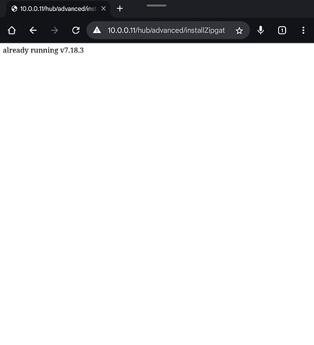

This is what I get upon running this endpoint
@jtp10181
This is what I get upon running this endpoint. It immediately says already installed. Did it retried severally, same results
Bummer, I am assuming you already tried doing the shut down and pulling power afterwards and the radio is still dead?
In that case, unfortunately, either the switching back and forth or possibly the radio restore that you did got the radio into a bad state. I would do a warranty ticket. Warranty – Hubitat Support
