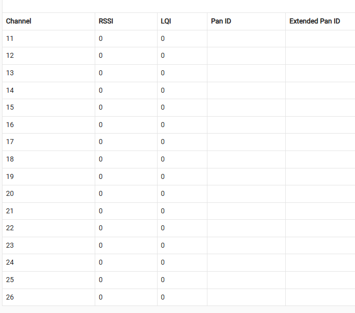

C8 Pro weak Zigbee channel, confusing channel scan
I understand that the message might be spurious. (I've clicked the Dismiss link but it does nothing.)
For grins, I did a Zigbee channel scan, which shows nothing!
What am I missing? Is it actually worth changing the channel?
(I have exactly 2 Aeotek leak detectors. They are 10 and 20 feet away from the hub, though there's ductwork in the way for the first and a fridge for the second. They do seem to be communicating just fine.)

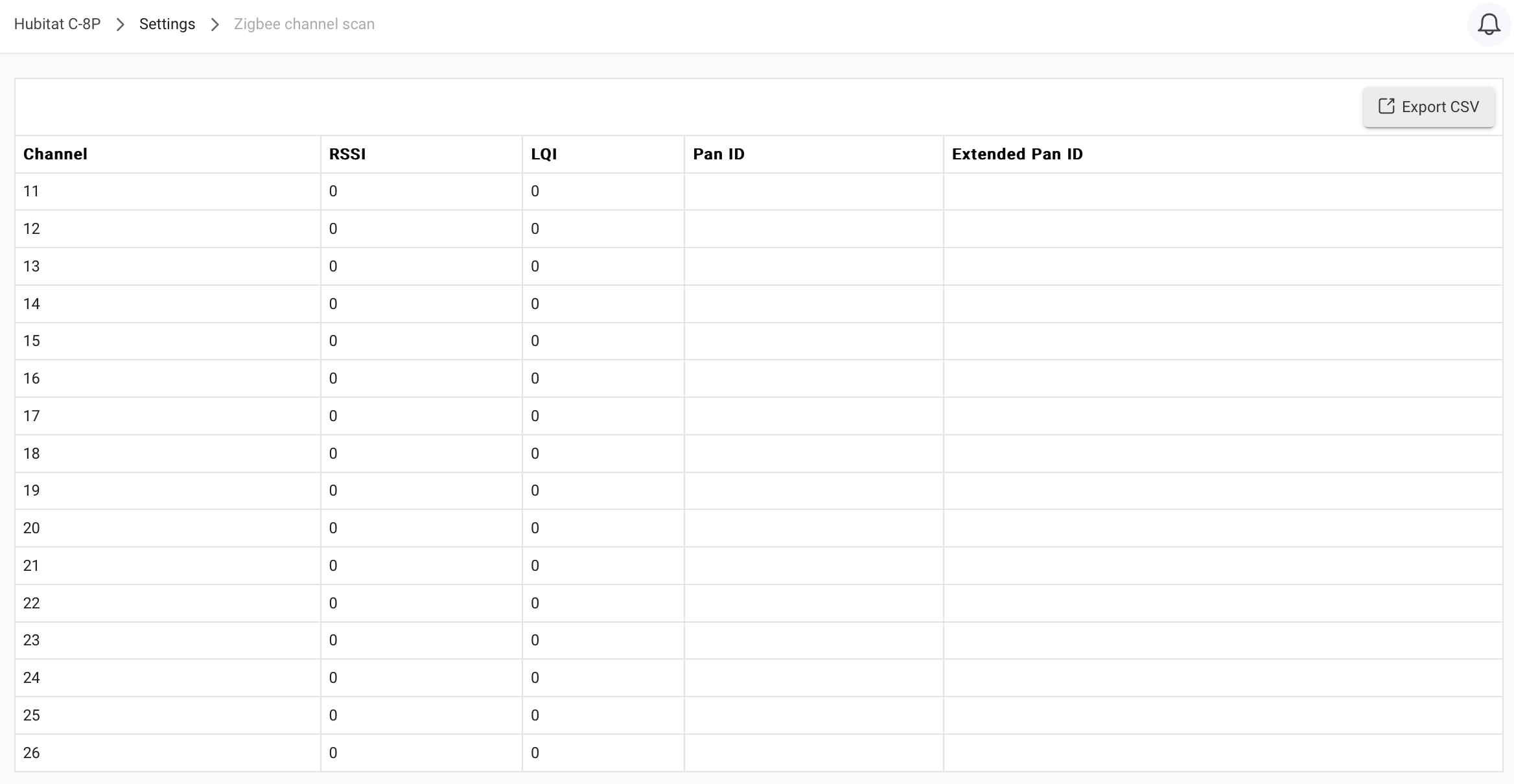

Here's what my scan looks like:
Original (nothing populated):

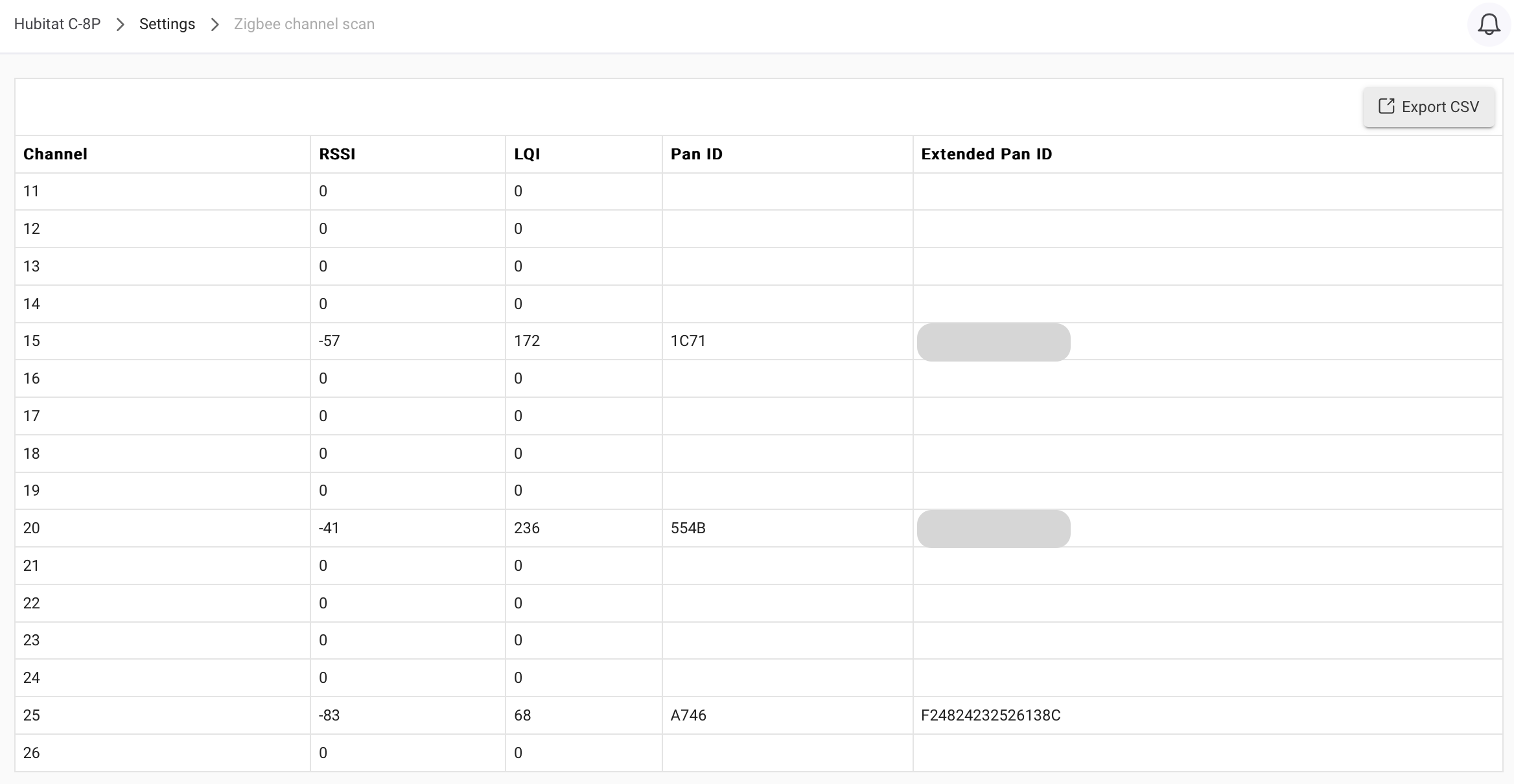

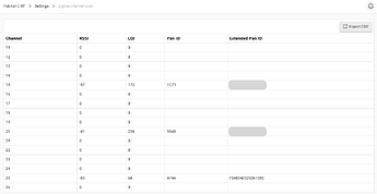

Reload the page (everything populates):
The coordinators on Channel 15 & 20 are mine, with 20 being the C-8 Pro. Both signal and LQI values are excellent. So the message about channel 20 is spurious.
The coordinator on Channel 25 is one of my neighbors.

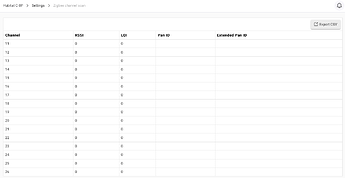

Refreshing the page never gets me any info at all, which is confusing. (Refreshing the page in Brave or Firefox gives the same behavior. It has the appearance of starting a fresh scan each time.")

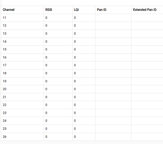

I still get nothing but zeros on my channel scan, no matter how I refresh. Do I need to worry that my C8 Pro radio might have an issue, or is this more likely to be a glitch in the current firmware?
Everything's working, but by nature I'm not inclined to ignore warnings.
