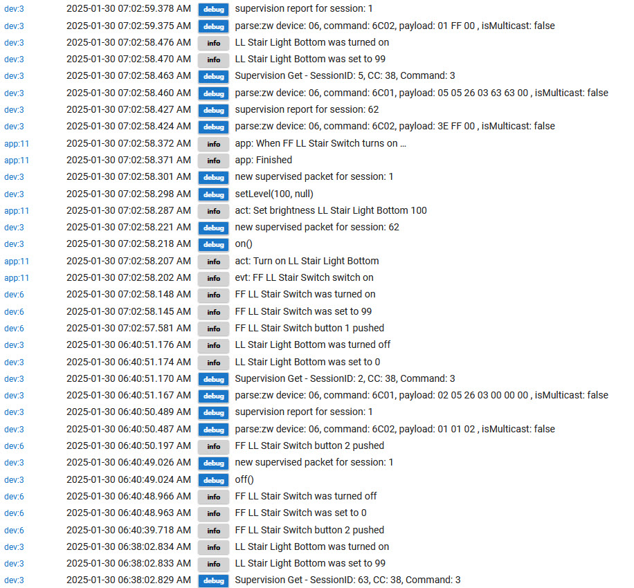

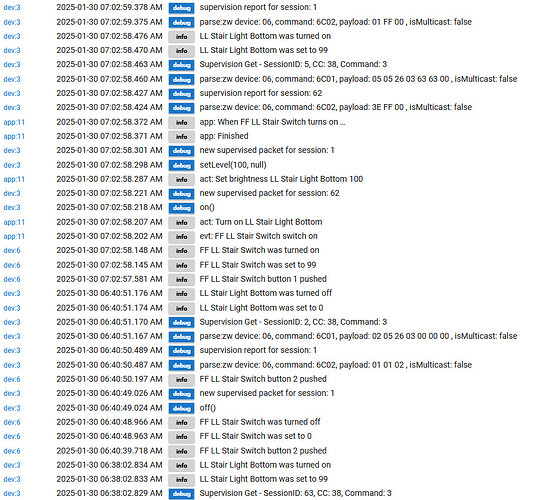

Here is the log for one of the switches

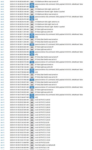

Hub 1, today's log and device list
Hub 2, today's log and device list
The log for Hub 1 show no activity today, although I physically turned the switch on and off and it did not record in the log.
The log for Hub 2 I ran the rule from the application and it then activated all of the switches and it logs that I turned on the physical switch and the rules all ran fine.
