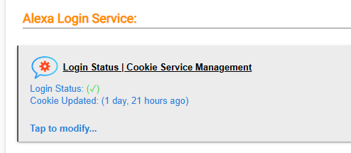

Go to Alexa Login Service and click to open:

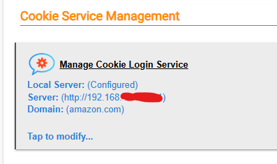

Go to Cookie Services Management and click to open:

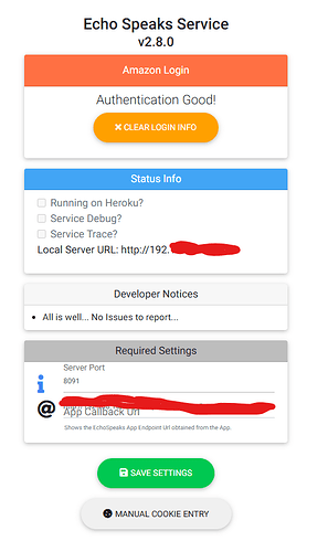

Go to Server Management and click to open. You should get a window like this:
Enter the call back URL in the spot at the bottom of the page, per the Echo Speaks directions:
"* * First fill in the callback URL and click Save Settings
- Then log into Amazon using the button at the top and wait to be redirected back to the settings page (do NOT click Save at bottom again)
- Close server login tab and the callback url popup
- Go back to the Hubitat app browser window
- Page should refresh and show you are logged in (otherwise press next)"
