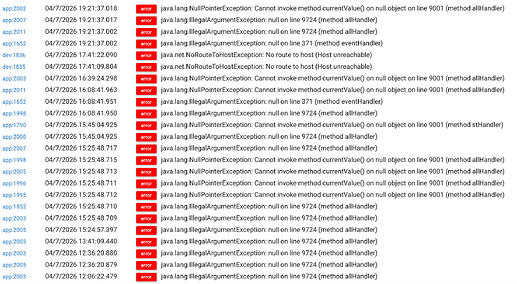

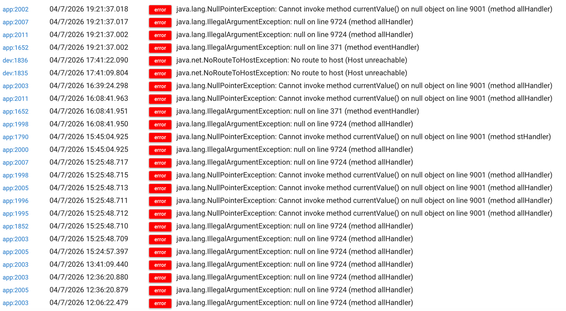

Trying to look at what's wrong but the hubs UI is painfully slow loading in the browser. I opened the logs page and it is full of errors and all for different rules:

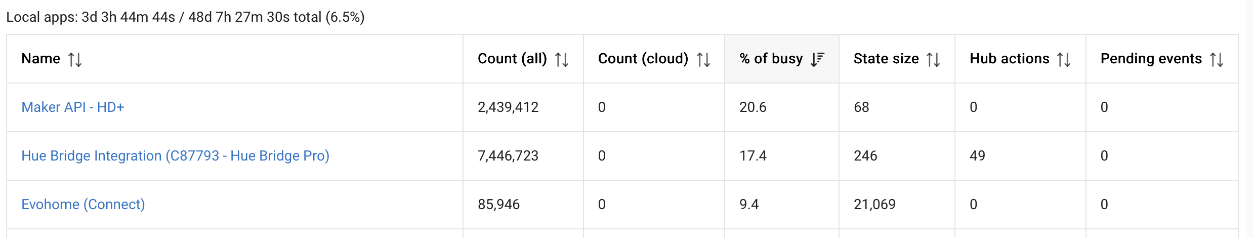

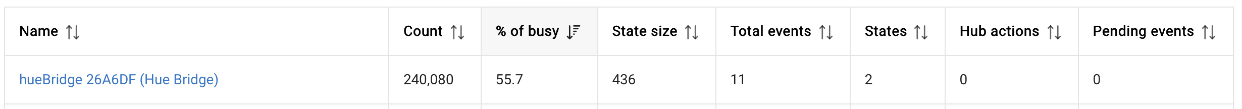

Nothing looks an issue in app stats and device stats either:
