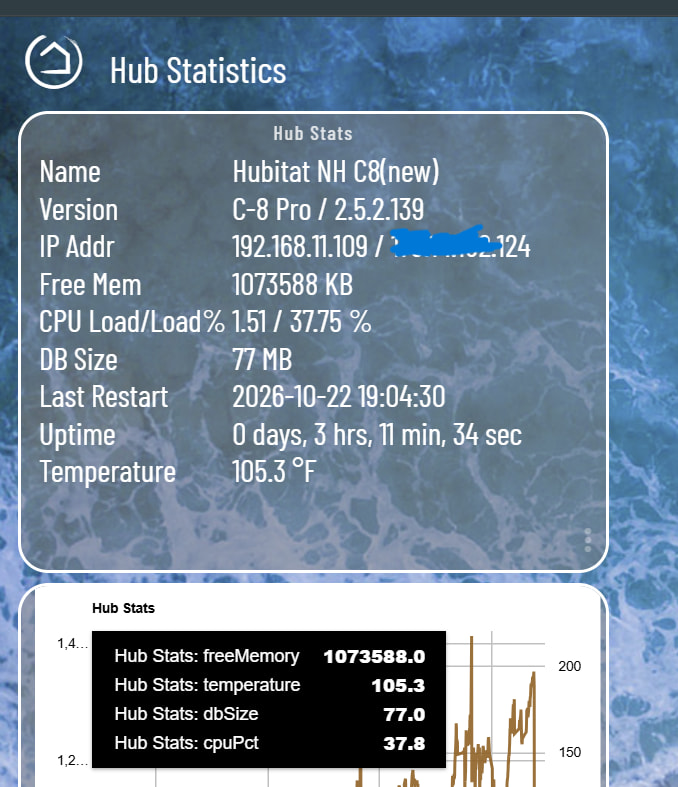

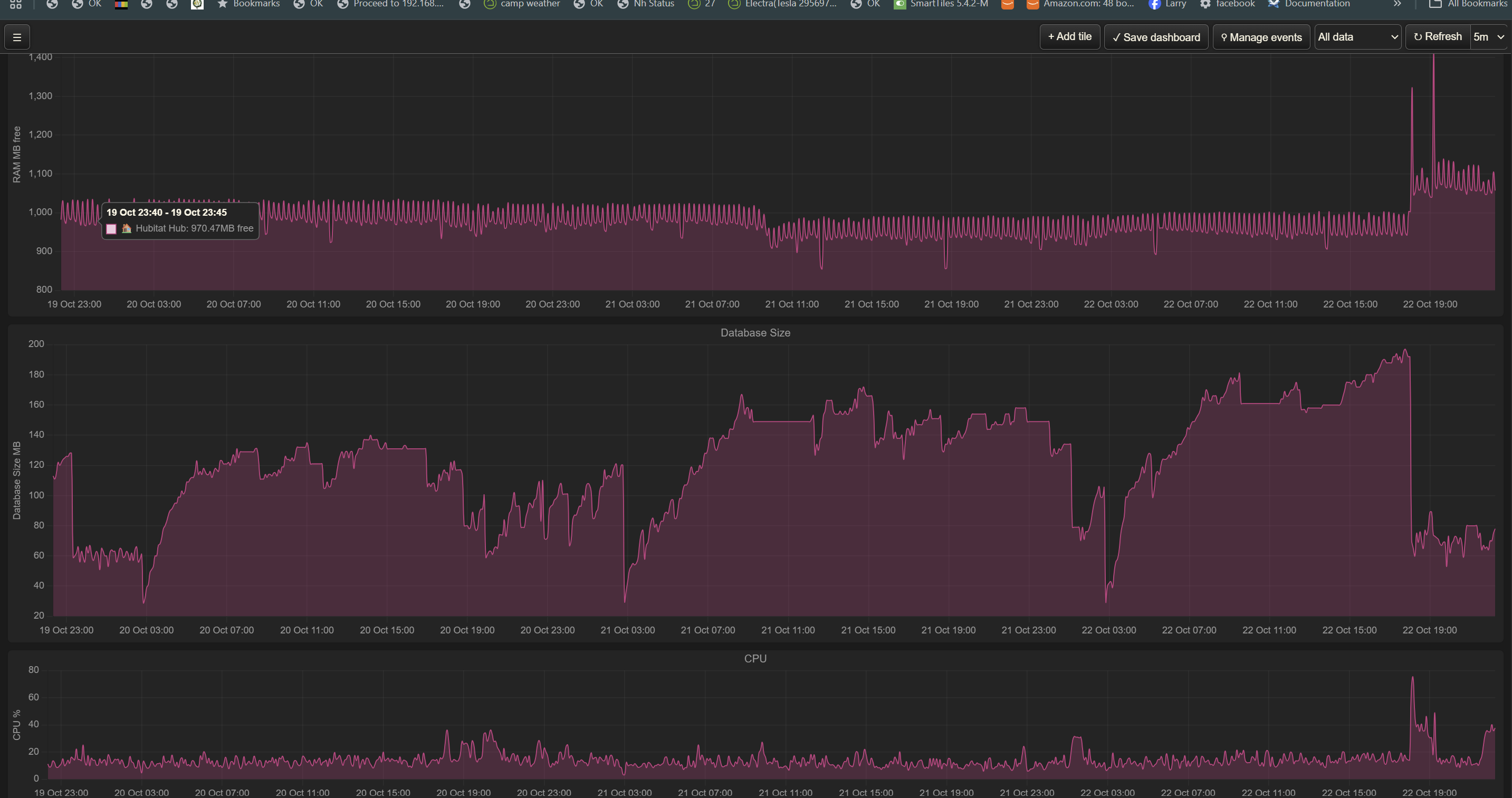

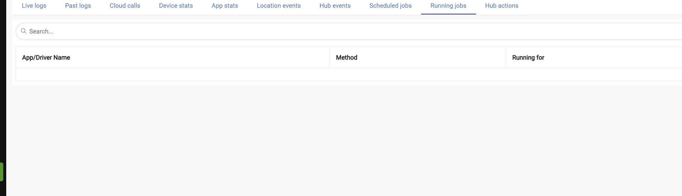

run away cpu.. been up for over 3 hours still 30+ percent cpu that is not normal see graph below.. tried reboot with rebuild went down and then started again.. my nightly maint is not till 2 am.
@gopher.ny

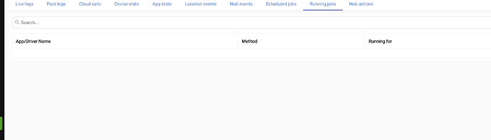

not sure what is going on doesnt show any running jobs in logs, and nothing untold showing in percent wize for apps or devices..

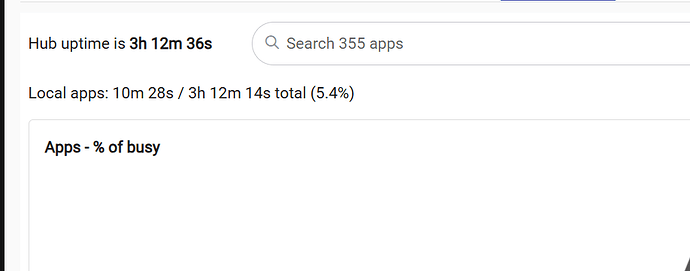

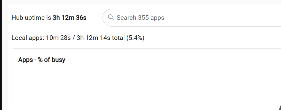

your apps are using 5.4% of all the cpu time

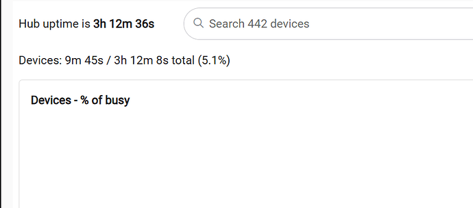

your devices are using 5.1% of all the cpu time

the crazy numbers are not that but the 37% cpu not explained by my app or device usage.
it eventually went down but a system process should not run for 4 hours consuming 30 some percent
if you look at the graph my normal is 10-14 percent

seems to be still there or maybe a little better havent had it up that logn but there is a bug related to the app and device status where it does not seem to be clearing out those settings on reboot.. note i have been up for 27 minutes and those stats are obviously wrong

this is much better after a couple of hours so i am seeing some imporovement obviously
