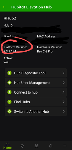

C8 Pro 2.4.0/App 2.0.9 - Platform version in Android App isn't current
The platform version shown in the Android Mobile app:
Isn't the same as on the browser (which is accurate):
Any ideas why?
Same for me... Hub is on 2.4.1.111, but Android app is wrong.
Same here. Hub's data is 2.4.0.151 but the app has it as 2.4.0.145. However, if I bring up the diagnostic tool on the app, I do see the correct platform version.

Before Logout - Login App on right
After Logout - Login App on right
