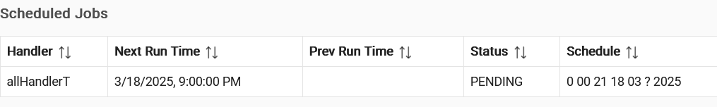

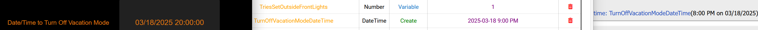

When set to 3/18/2025 at 8:00pm (using a "variable" tile on a dashboard that references the Hub Variable), the "Hub Variables" list shows 9:00pm and the Scheduled Jobs "allHandlerT" shows 9:00pm as well--but the dashboard tile and the RM5.1 "Trigger" show 8:00pm. It appears to actually trigger the rule at 9:00pm, despite what the "RM Trigger" shows.

Dashboard, Hub Variable List, and RM Trigger display:
RM App "allHandlerT" value:
