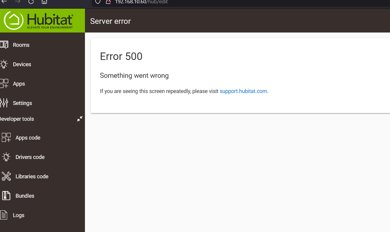

One other thing you could check besides the above steps, would be Logs > Hub Events tab (or maybe Location Events). Look for any messages about zwave crashing. Its not very common but if zwave keeps crashing that could indicate a hardware problem.
ip address shows active along with green light on.
