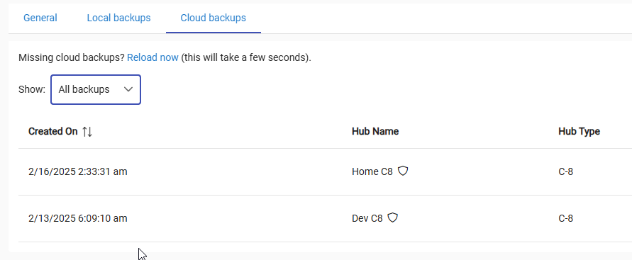

FWIW I decided to test this for myself. I have a C7 without hub protect on 2.3.9 still.
Created Backup
Cannot see it at all from C7 (not sure why these show up? Maybe because they have hub protect, in case I needed to migrate to a backup hub due to failure and then transfer subscriptions?
CAN see it from the C8
