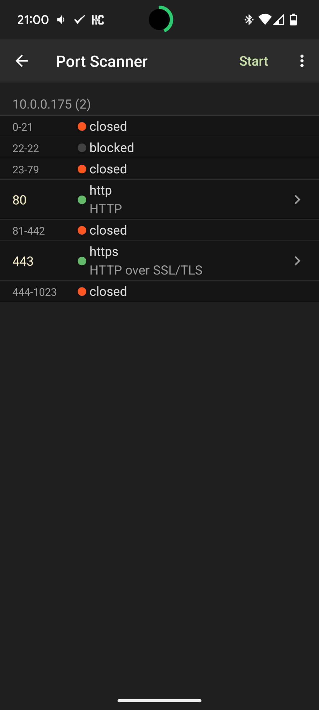

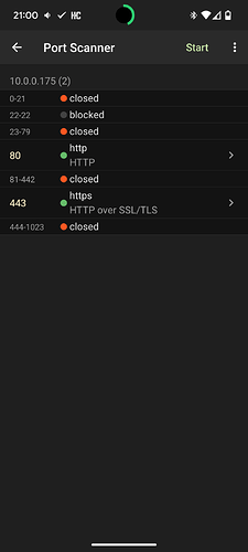

Cannot connect to the Diagnostic Tool. Chrome says "This site can't be reached."
Can ping the hub with 14-75 ms response time. Ports 80 and 443 are open.
Not sure how long you waited but maybe diag tool is just not booted up yet. If LED is blue and you can reach the IP the diag tool should work.
Waited about 10 minutes, just after posting my response, the Diagnostic Tool stated. Will do the soft reset and restore from the last good backup.
