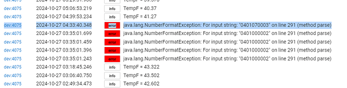

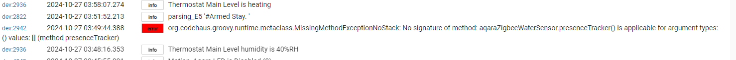

Looking back in my logs I see only two errors, neither seem likely to cause a lockup:

What is device 4075?
It was (since deleted) a custom (my me) driver to read the temperature of a SHT30 sensor through a Zigbee cc2530 radio.
I've had others (slightly different) running for a couple of years (C5 --> C8). I've deleted it as a potential lockup cause.
