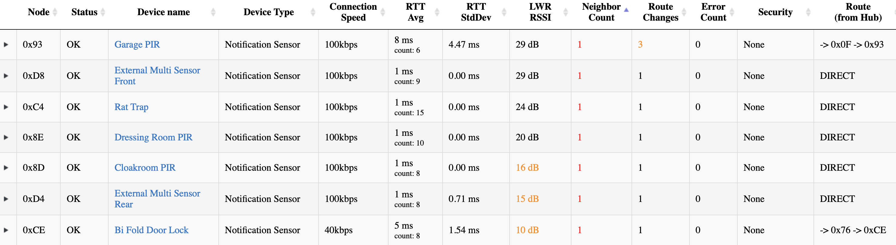

After more than 36 hours of migration all but one of my notification sensors only show one neighbour. They're working ok but that surely can't be correct can it? Whenever I've added a new one previously the number of neighbours has shown up within hours. Prior to migration all of the below notification sensors had double digit numbers of neighbours (the bi fold door lock in the table was always just 1 or 2)
I'm keeping an eye on the mesh details as so far the direct routes are the same but all RSSI values are far worse than they were on the (unmodified) C7 in the same location for all devices.
