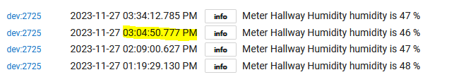

Yes, the events or logs show that the error times line up with one of the sensor changing state - the sonoff sensor.

Yes, using custom driver for the bathroom (sonoff sensor) and both Hallway and Living room are switchbot sensors which are integrated in HE via Home Assistant / Home Assistant Device Bridge.
However, I can now see that the recent errors are in line with all three sensors... so, it's not likely to be sensor related?
