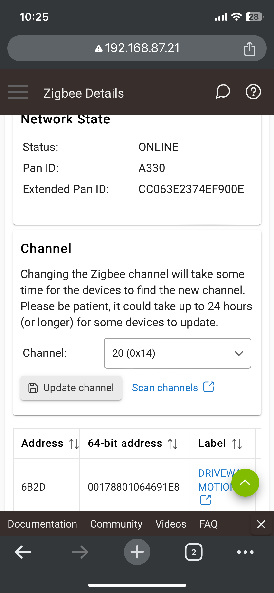

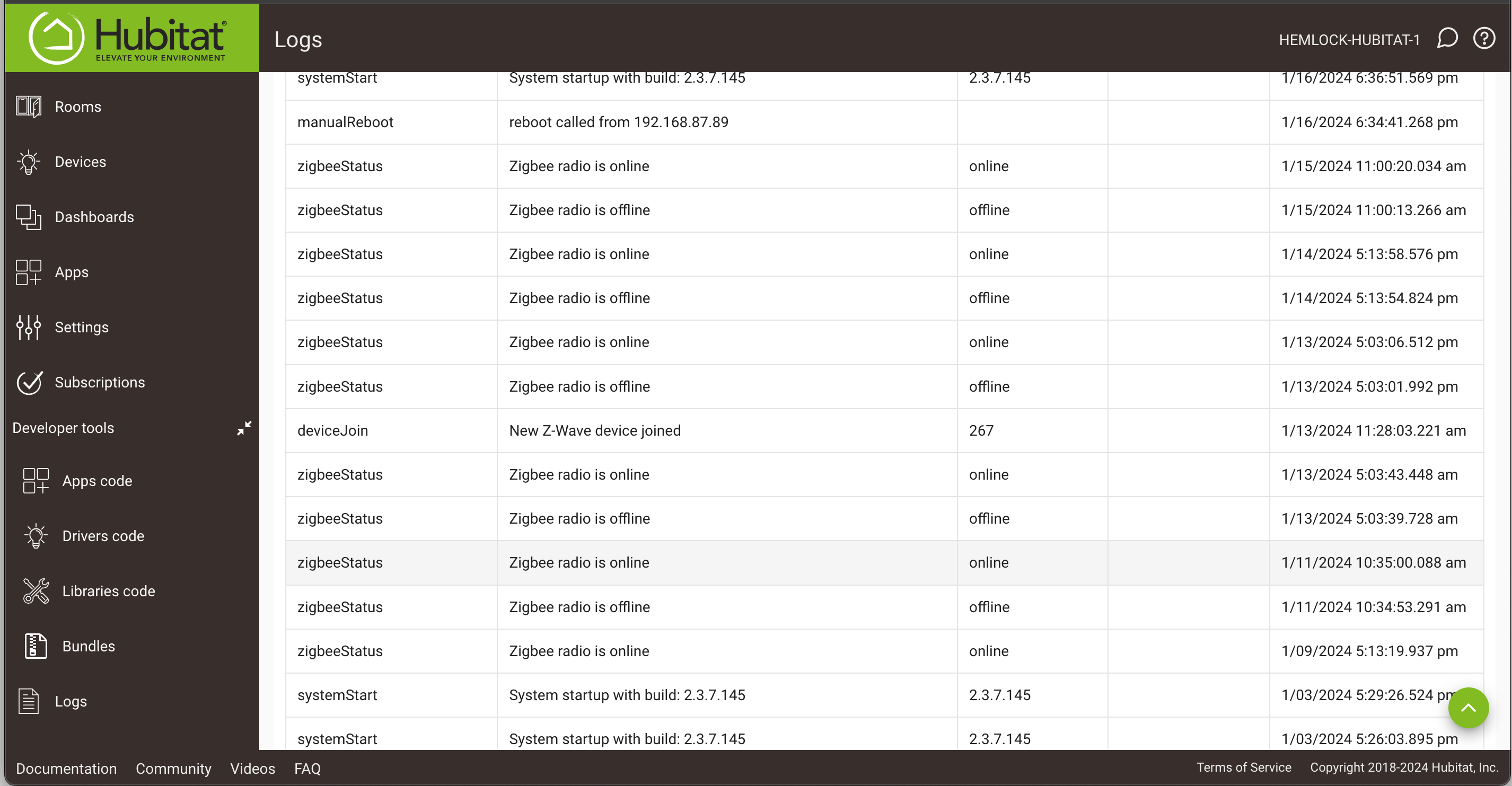

I've tried rebooting the hub, shutting down the hub, disabling/enabling the zigbee radio, restore the database; all with little to zero success.

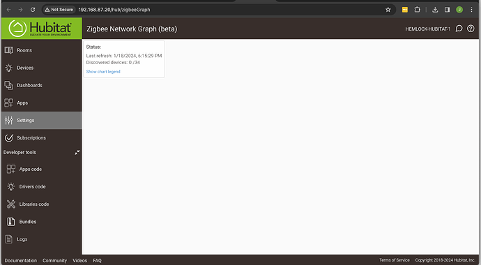

When I try to look at the zigbee device graph, I see zero clients.

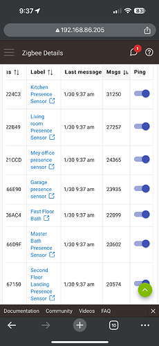

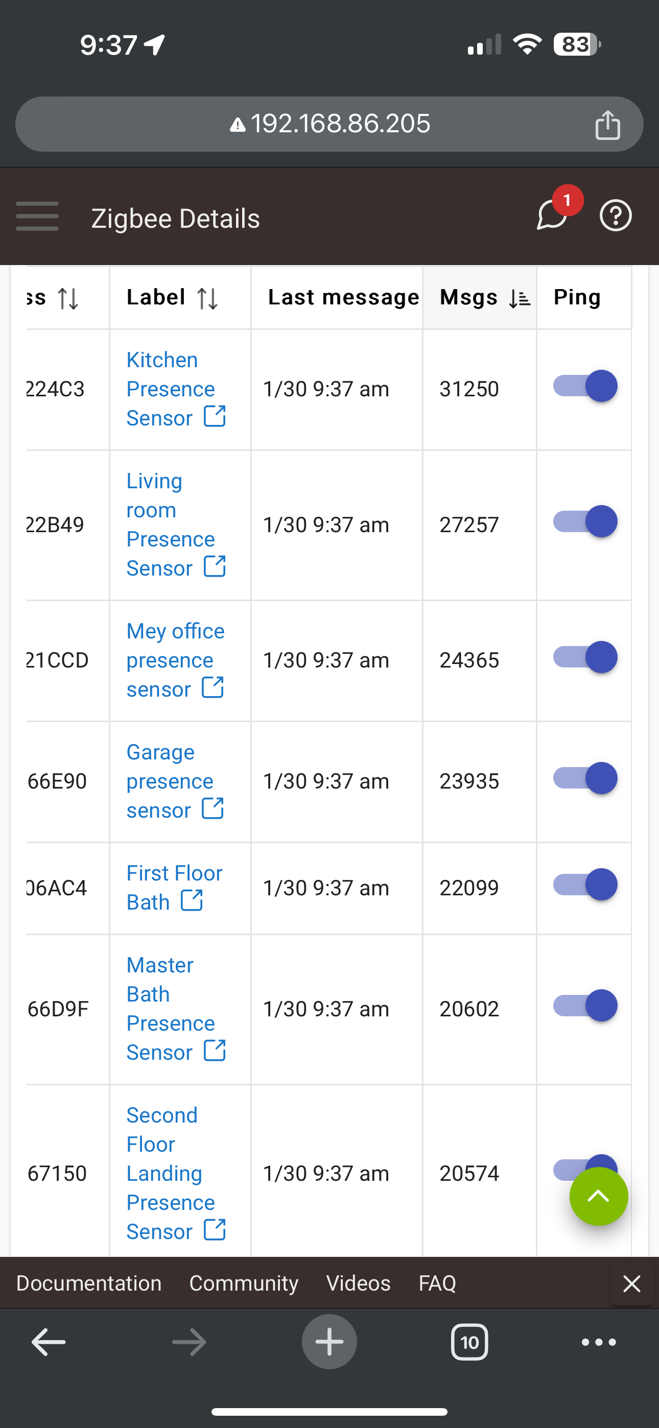

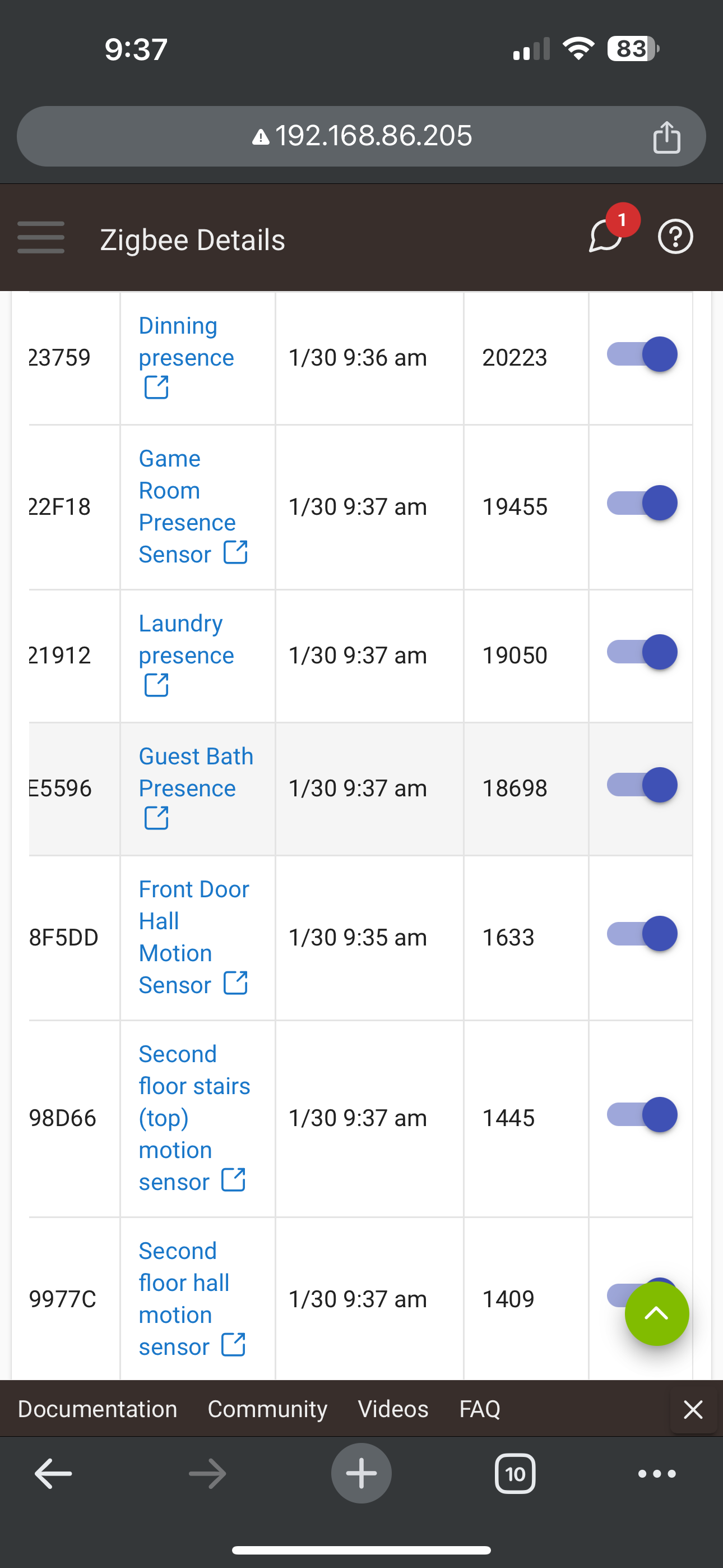

Any chance the beta device or any of the Blues are (unintentionally or erroneously) spamming / overwhelming the mesh with overactive reporting?
The only other left-field idea I had was to sprinkle in a couple known-to-be-good ZB repeater devices and see if they could help stabilize that mesh's backbone a bit.
It could. I don’t have a sniffer to check. I would expect other platforms having similar broadcast issues if it was spamming; however, I can’t rule it out.
The hub is centrally located and always seem to have great coverage with the internal antennas. Just mainly wanted to see if there was anything to grab on the Hubitat side before I blow it out and start building the mesh again.

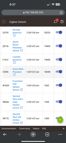

I also started having this same issue about a 1-2 weeks ago. It’s like all the bliss just fall off the network (15-20 devices between dimmers and fans). Air gap them and then they instantly work again for a few hours/1 day. I do have lintech pretense sensors as repeaters also. And I’ve also rebuilt the network as swell as powered down for 2 hours. No improvement. As OP said also wave switches are working fine. And I’ve updated the drivers to latest inovelli release with no improvement
I crunched some numbers and I think combined with all 4 sensors it would come out to around 1 message being sent every 10-20 seconds. Thats assuming uptime is 5-7 days, and assuming they are evenly spread out. If they are quiet for a while (like at night) but then spew stuff out in rapid succession at time it could be causing an issue.
