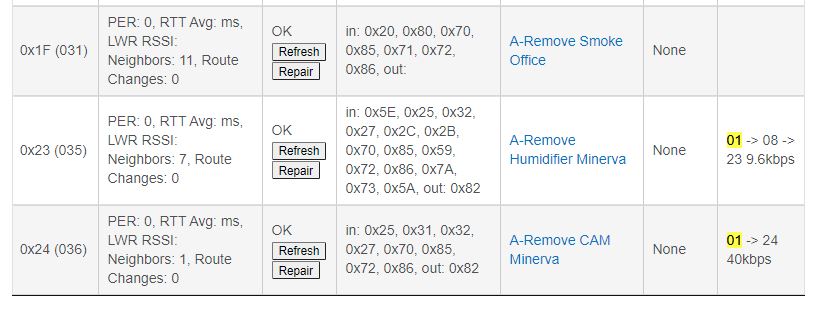

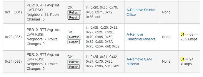

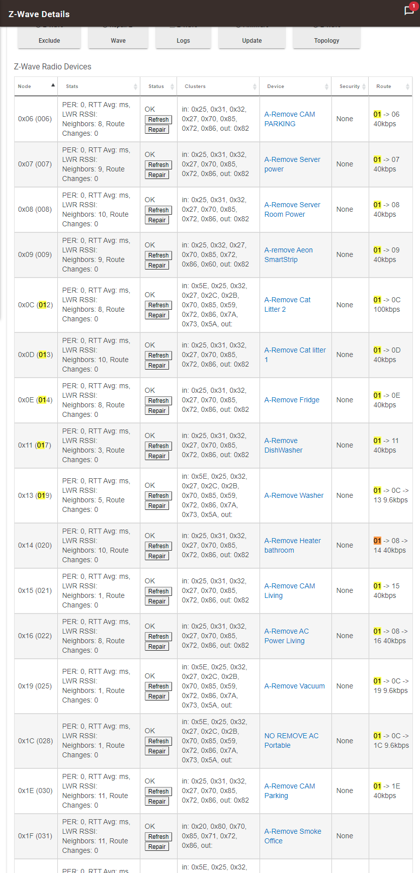

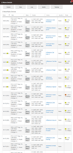

I see what's going on. After pairing 18 nodes, 17 of them became unreachable (according to logs after network repair). Also, I see that their Routes are all linked to a... non-existing node (node 01)... And, yep, did cold reboot, same route, all of them except one are routed through a non-existing node... no wonder why this can't work. This has to be a bug in their firmware. @bravenel ? @bcopeland ? Any idea how to reset all SUC's ?
Node 01 is the hub..
Can you post a screenshot of your z-wave details page?

Please see the PM I sent you..
Thanks for the help! For future readers: I can confirm it’s a matter of doing things the proper way: do not exclude and run repairs at the same time do not associate far away from the hub and do not chew the hub either… although I was really hoping chewing it would help. I think @bcopeland will now have enough data for future foolproof of the association process… for he had to deal with the best fool ever! lol thanks everybody and thanks again @bcopeland!
