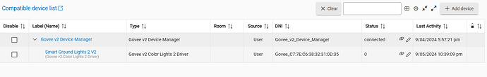

Slight correction: My dashboards are still empty.
Thanks for all of the help/direction. Much appreciated. There's a slight difference between the two platforms/code sets.
Above, when I saw "No Devices" I assumed that my dashboards were empty and they weren't. I still need to understand functionally what adding the devices here does, but it didn't mean what I thought. Again, thanks for everything I feel like a migration expert now (I must have upgraded/downloaded, soft reset, around 20+ times!!!)
