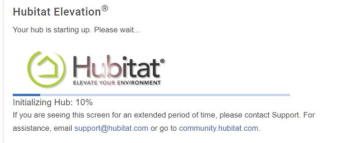

Hello,
I got a C7 hub from my dad who had an extra one. I was able to reset the IP address to be able to connect to the hub. However when I try to reset the hub in order to connect to my system, it gets stuck at 10% when initializing hub.
I have tried rebooting and the 'soft reset' option on the diagnostic page, but it does not initialize the hub.
It does ask about upgrading firmware (currently at 2.2.7.128) which, if I try to upgrade it doesn't succeed. If I say continue on 2.2.7.128 it goes to initializing hub but sticks at 10% as mentioned.

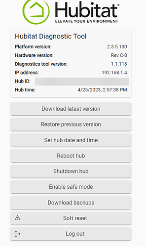

Here is current diagnostics tool.
Usually Download Latest and then Restore Previous > Select Newest will get it past a stuck update.
