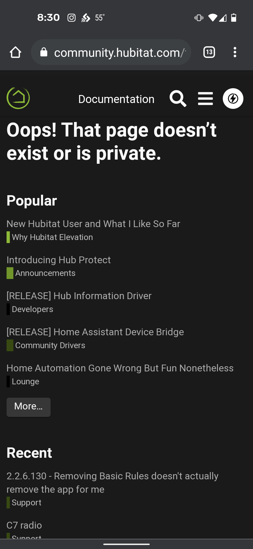

PS, @dennypage your link doesn't seem to work
Strange that the link doesn't work. It still works for me, but I have to be logged in to see it. Are you logged in?
Can anyone else see the post?
Link worked for me too.
It’s in the Debate Chamber so depending on how long you’ve been a member you may not have access...
Hmm. I've been here for years.
Yea, but you may not be as argumentative as the rest of us.
Well yes. Agreed.
I honestly didn't know that there were Time In Service restrictions on access to posts there. Shame the post was made in there then--it contains some valuable lessons learned.
