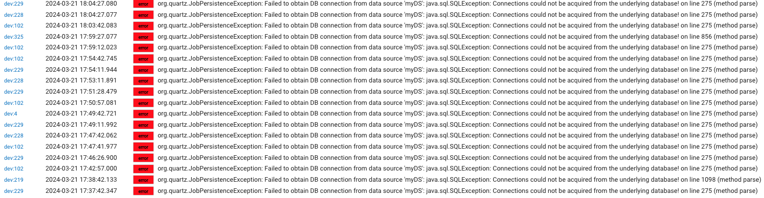

Rebooted the hub, seems back to normal. This is what I found in the logs :
No pattern jumps at me in the list of affected devices.
