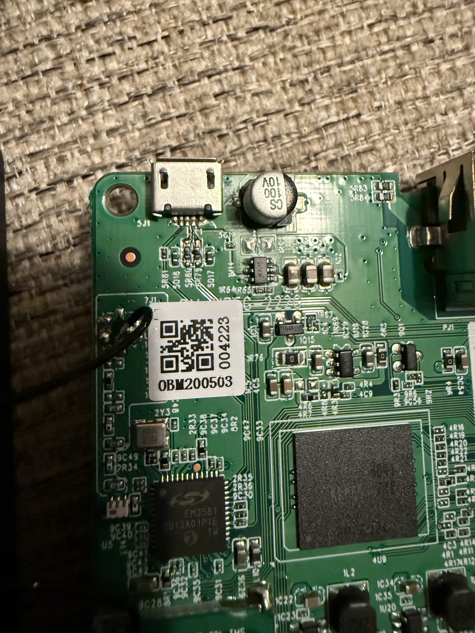

I looked at them. Hard for me to tell but they definitely look like they don’t make solid contact with the board. So tiny though. Any spots on the board to direct connect power to?
Do you have a soldering station? Others have re-soldered or reflowed those contacts. Any electronics repair shops near you?

Can you take a detailed photo of the microUSB connector and post it?
We'd need confirmation from someone with better eyes than me. MicroUSB is powered by pins 1 and 5. And it seems to me that the solder on pin 5 (closest to the cap) is not okay.

In the meanwhile, plug it into power and gently apply pressure from the top. If it powers up, then you know it's an issue that can be resolved.
It's not really your eyes because the image is blurry at that magnification. But Yes, I agree, the pin closest to the cap seems different from the others.
IF you had a spudger, you could use it to press those pins and power it up to get verification that the LED comes on at least. But yes, a phone repair shop will have the tools to reflow the pins if the 'spudger test' gives a positive result. (You don't need to power it all the way up. pressing on the pins.. the test is just to tell you if that's the problem. I think it's 15-20 seconds for the blue LED to light up.)
If the goal is just to get a cloud migration backup, and you can get it to power up by pushing on the connector, might be able to just tape or hot glue it in place temporarily so it will stay on long enough to make a backup.

You guys are absolutely brilliant. Got it up to blue then green but lost my grip. Got it holding stable but can’t get it off blue anymore. I can log in through 8181 and get to the diagnostics. Can I do the migration from there?
Do a soft reset. See if it comes back with the platform.
