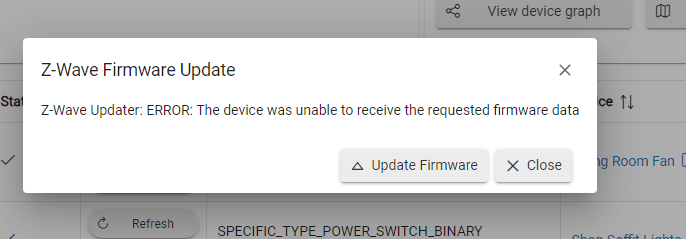

2.) I checked the Zwave details page and did have a "Firmware Update" buttons so I selected it
This began the download/install process for the firmware update. It got to about 70% or so and had the following error:
I did not do step 3 due to the error in step 2. I then read some of the other posts that had issues.
I then powered down/unplugged and rebooted the hub.
I checked the version using the hub/advanced/Zwaveversion from the browser. Unfortunately I did not capture that result but it did not appear to be version 7.18.
I have since followed the steps in the first part of the linked post:
  1. Updated hub (already done as noted above)
  2. performed command install/Zipgateway715
  3. rebooted hub
  4. Went to details page and selected "Update Firmware" again.
    Again I got the same error that I got above, "device was unable to receive the requested firmware...."
So at this point I am not sure what to do to move forward. This is what the version web command shows:
VersionReport(zWaveLibraryType:7, zWaveProtocolVersion:7, zWaveProtocolSubVersion:17, firmware0Version:7, firmware0SubVersion:17, hardwareVersion:1, firmwareTargets:1, targetVersions:[[target:1, version:7, subVersion:15]])
Any help would be greatly appreciated.
