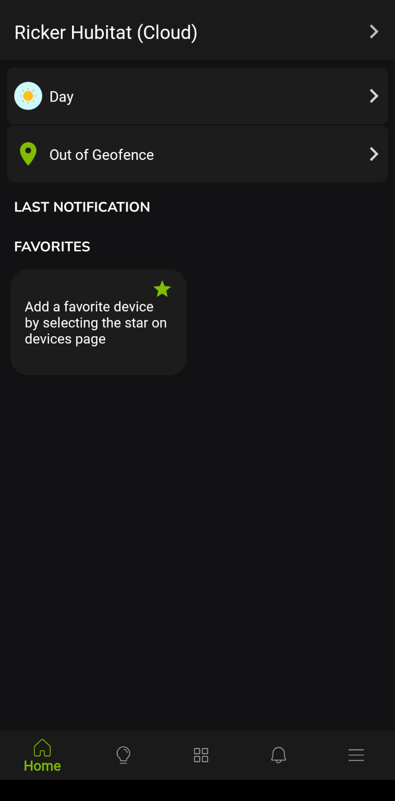

Thank you. I tried that and moved to a backup from a few days ago. Same thing. Intermittently controls the closest devices. No response on anything else. I'm not sure if this means something, but in the app my hub now says (cloud). I don't think it used to say that. As such, it no longer lets me connect to the dashboard via the app for some reason.

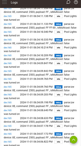

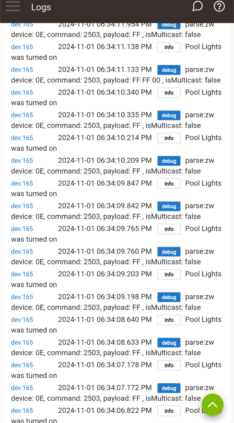

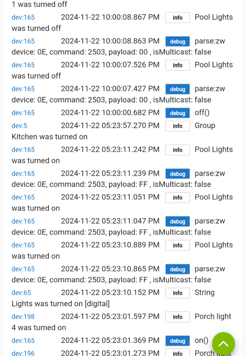

As for logs, there's a ton of entries today as I've done a lot of resetting, z wave repair, testing, etc. But these errors started showing up recently.
Looking back, I installed those new lights on 11/3. These errors were existing prior to that.
