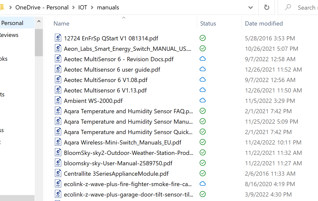

When you get a new device, save away a PDF of the manual to a folder in Google Drive or OneDrive. If you are manually moving all your devices now as part of this upgrade, as you find for the instructions for your devices similarly squirrel them away in that folder. Sometime in the future when you need this information again, you will thank yourself.
Mine looks like this: (I've got all this unused OneDrive space, so I use it just for this purpose)

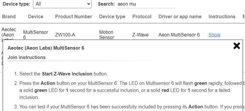

Another resource is it the List of Compatible Devices page, which has a link that shows pairing and reset instructions (you may need to scroll right to see it).
I humbly suggest that if you fallback to that page for your instructions, you either save a screen shot or text of the instructions for the devices you lookup.
