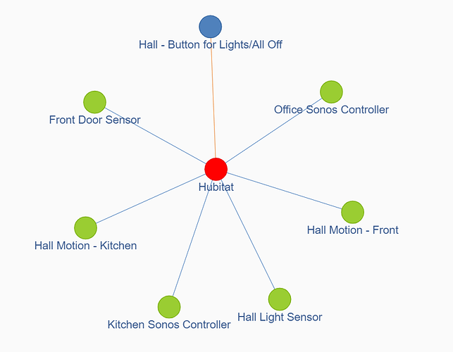

So my idea for this C-8 connectivity problem showing up only when thee are incompatible Zigbee repeaters/routers may be wrong ... (
Just in case, check your Zigbee map - is there any device shown as a router? (blue dot)

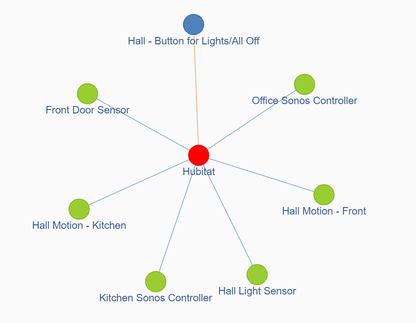

This is mine, very simple! I've had no new devices added since I successfully added the current problem device to my C-5 a few weeks ago
Actually, I have a button turn turn everything off downstairs which isn't showing above, just pressed it and it is now showing. The blue one is a battery powered zigbee button, had it for over 2 years though
It is very unlikely that the battery-powered button is a router, more probably this is incorrectly reported/determined routing functionality.
As a last idea - remove the battery from your problematic Ikea button and try again tomorrow, after rebooting the C-8 hub.
Might be worth looking at the getChildandRouteInfo for the hub; prior to the C-8 this was usually a reliable indicator of the hub's direct connected child devices and neighbor routers. Rarely (even with the C-3) I have seen it confuse child devices with routers, but it usually straightens itself out after a while. It's also more of a 'realtime' indicator without the confusion factor of past/present routing history that the depiction of the Zigbee graph is prone to,
