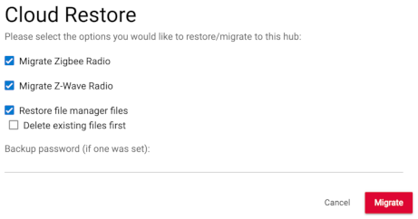

Make sure you are selecting both radios when you do the migration restore...(assuming you have Zigbee devices as well). There is a point in the migration steps where you are able to choose what to restore...
You're following the steps laid out here, right?
Yes, I followed the instructions to a T. No encryption lock enabled, checked zwave, zigbee and files when restoring, etc. For some reason the zwave restore (or maybe backup) is silently failing in the background. I have tried several C-8 Pro migration backups and several restores and none of them restored my zwave database. Not sure if there is a way to troubleshoot in the logs or SSHing into the Hubitat or something but just following what is available in the UI is not working.

Were you using the same backup from your C8 for all migration attempts? In other words, did you try to do a fresh backup to the cloud for every migration (see screenshot), or did you just use the one for all tries?
If the original upload was incomplete or damaged in some way, it wouldn't migrate properly.
I also would do a reboot on the original hub, and be sure to check the box for advanced options, and do a database rebuild. I would do this before doing a fresh backup.
I used the create a cloud backup for c-8 pro migration several times making new backups. I tried doing a factory reset of the c-8 pro as well. Also making sure the c-8 was shutdown when upgrading the pro.
