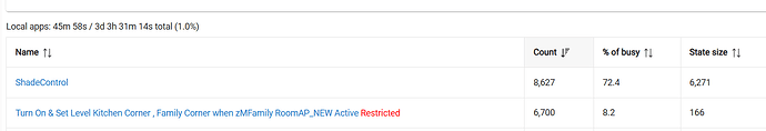

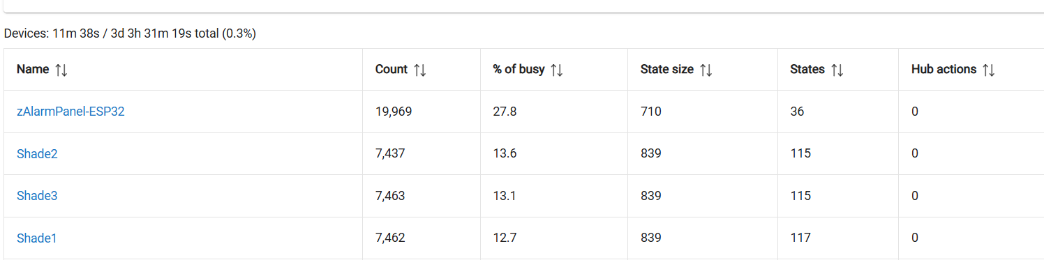

Based on the Z-Wave troubleshooting document, I prepared my "to do" lists and working on them. While reviewing Logs, I have captured partial Device Stats and App Stats at below. Need to learn on these data and significance of the data on Hub's performance. Could you please direct me to the documentations on these data? What to look for poor performance? Any data point indicates any issue with the hub?
Any suggestion will be appreciated.

There isn't much, and that's because there are no hard and fast rules. They are just ways you can get some insight into where to start if anything stands out (with <= 1% of time usage since your last boot, I'm not really sure anything here does -- unless maybe you just rebooted and things have been quiet since then, in which case looking again later may be more revealing).
