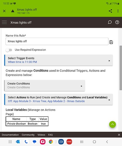

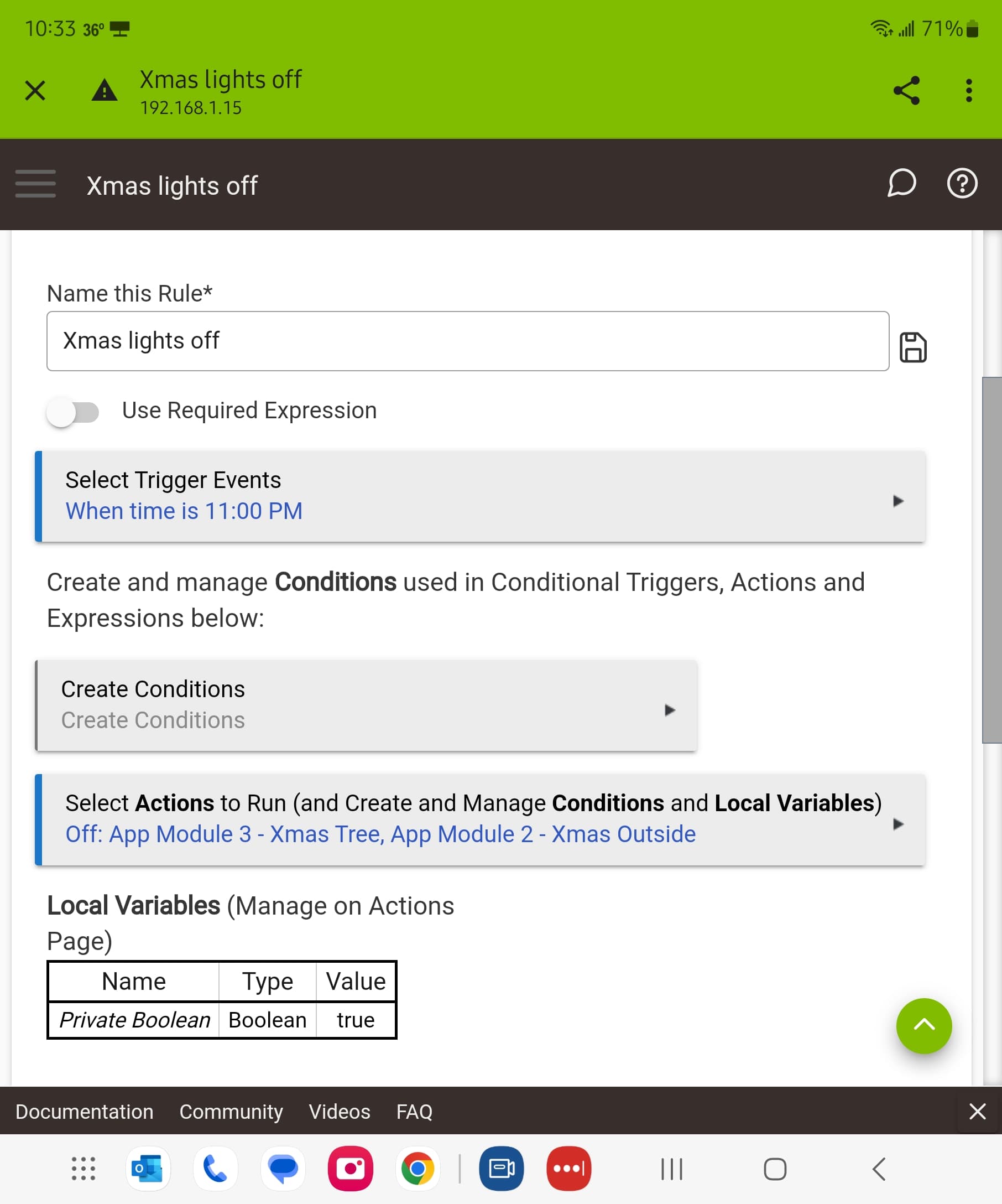

Time is set correctly, lat/long is set correctly. I set up a basic rule last night and of course it didn't fire.
This is basic stuff I'm doing here and I'm not an idiot. Something is major wrong with the hub and I guess the only thing to try is buy a new one or switch back to smartthings.
