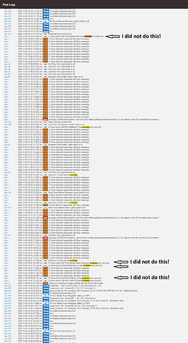

So there is something strange afoot at the Circle-K.. in addition to my on/off/refresh issue I seem to be getting odd exclusions that I never purposefully did. Not sure if a device gets stuck in exclusion or there was a delayed reset when I included the switches or what but it's very strange. Also not limited to Zen switches also happened to an Aeotec 7 repeater.
Also not sure what the excluding unknown devices are.. maybe my Z-Stick/UZB-7s.
I also pinky-swear I did not knowingly do these exclusions, honest :innocent:
Has anyone seen anything like this?
