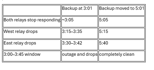

Every night, one or both relays switch off on their own. The hub doesn’t log an off() command. The relays report off only when polled, and they never send an unsolicited report.
What the logs show (Oct 1–15, backup at the default 3:01am)
- Drops on 12 of 14 nights, always between 3:15 and 3:40am
- The 12 nights where the relays dropped, both relays stop answering refreshes starting around 3:05am, for 5–35 minutes, even though they use different routes
- When they answer again, one or both report off. The two relays drop independently, sometimes 15–25 minutes apart.
- The two clean nights were Wednesdays, when a Rebooter App commands a restart of all five hubs at 3:00am. So, the hub is in the reboot process when the scheduled nightly backup is supposed to be running
- I changed the automation so the relays would turn on 2 hours before sunset. The early activation changed nothing (drops still at 3:15–3:30), which rules out run time or heat
The test
I changed only the Entry hub’s backup schedule from 3:01am to 5:01am. The other four hubs kept their 3:01 backups.
Another data point: a backup at 10:03pm, created when I saved the schedule change, caused no outage and no drops. Only the scheduled nightly job seems to cause it.
What I’ve already ruled out: power-cycling the relays, Z-Wave repair, re-setting the lifeline association, no other loads sharing the circuit, run time or heat, and the device driver (same behavior on Universal Z-Wave Switch and the erocm123 Enerwave driver).
