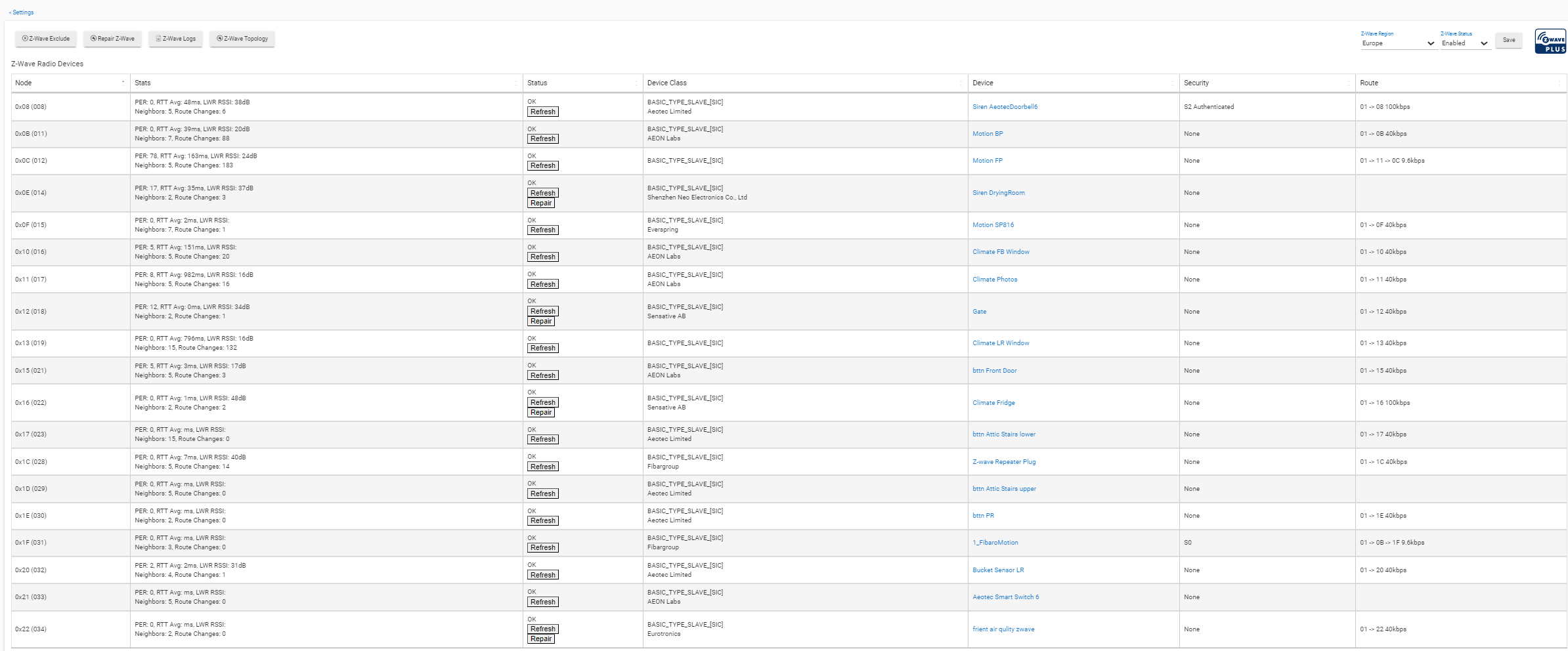

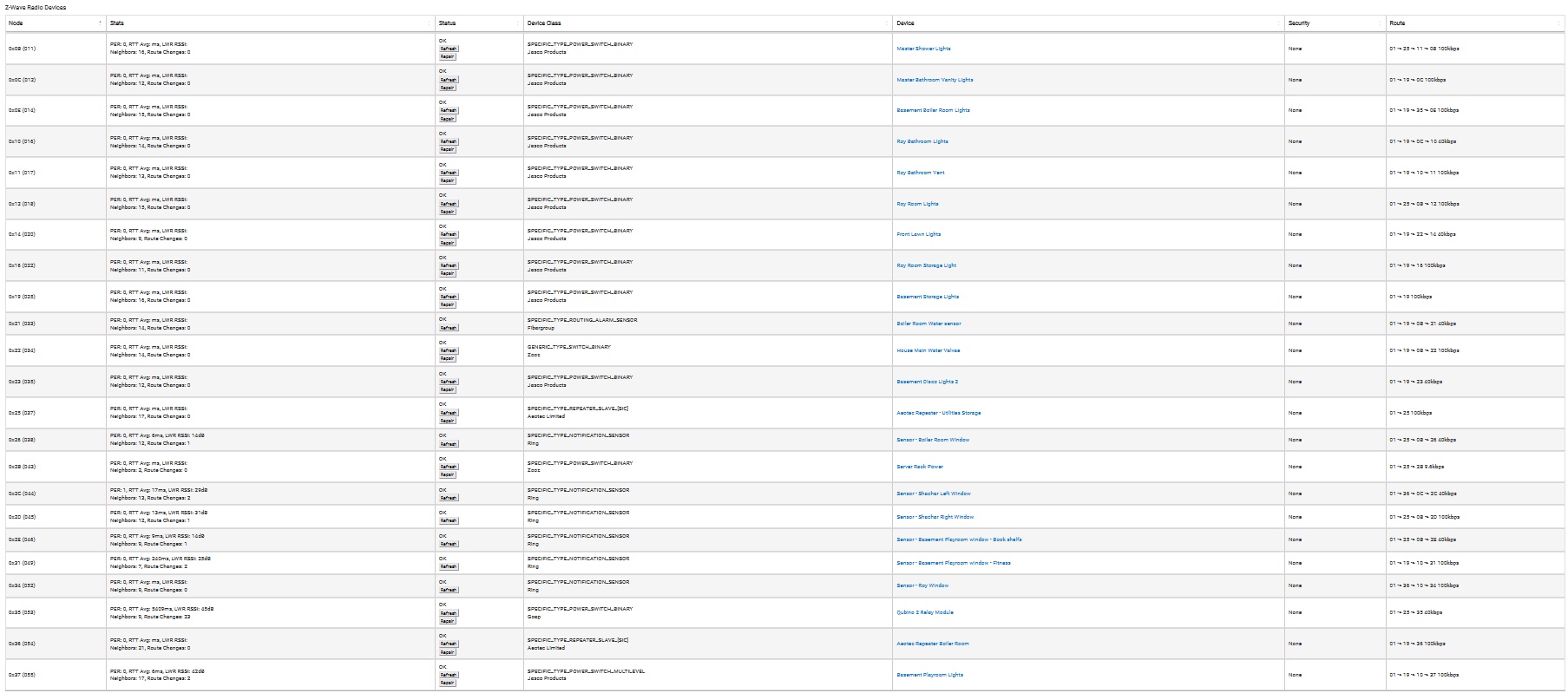

See below the z-wave table.
I tried to look at the z-wave logs but nothing unusual.
Not sure why that posted so small but sorry can't read it... but it also looks like you might have just rebooted your hub so some of the stats haven't had a chance to repopulate.

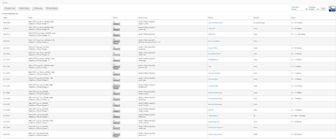

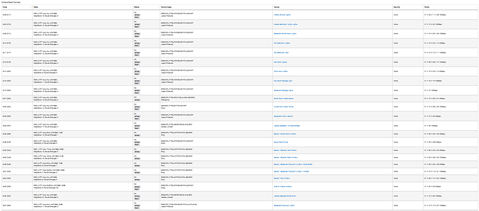

attached better view of the zwave radio.
What is the device refreshing every 10 seconds? That seems... excessive.
Interesting that the vast majority of your devices are repeating through just two repeaters... that jabsco switch and an aeotec repeater. Usually I'd expect not to see so much reliance on repeaters.
Would be interesting to see the reroutes... but it takes a while for them to populate,
