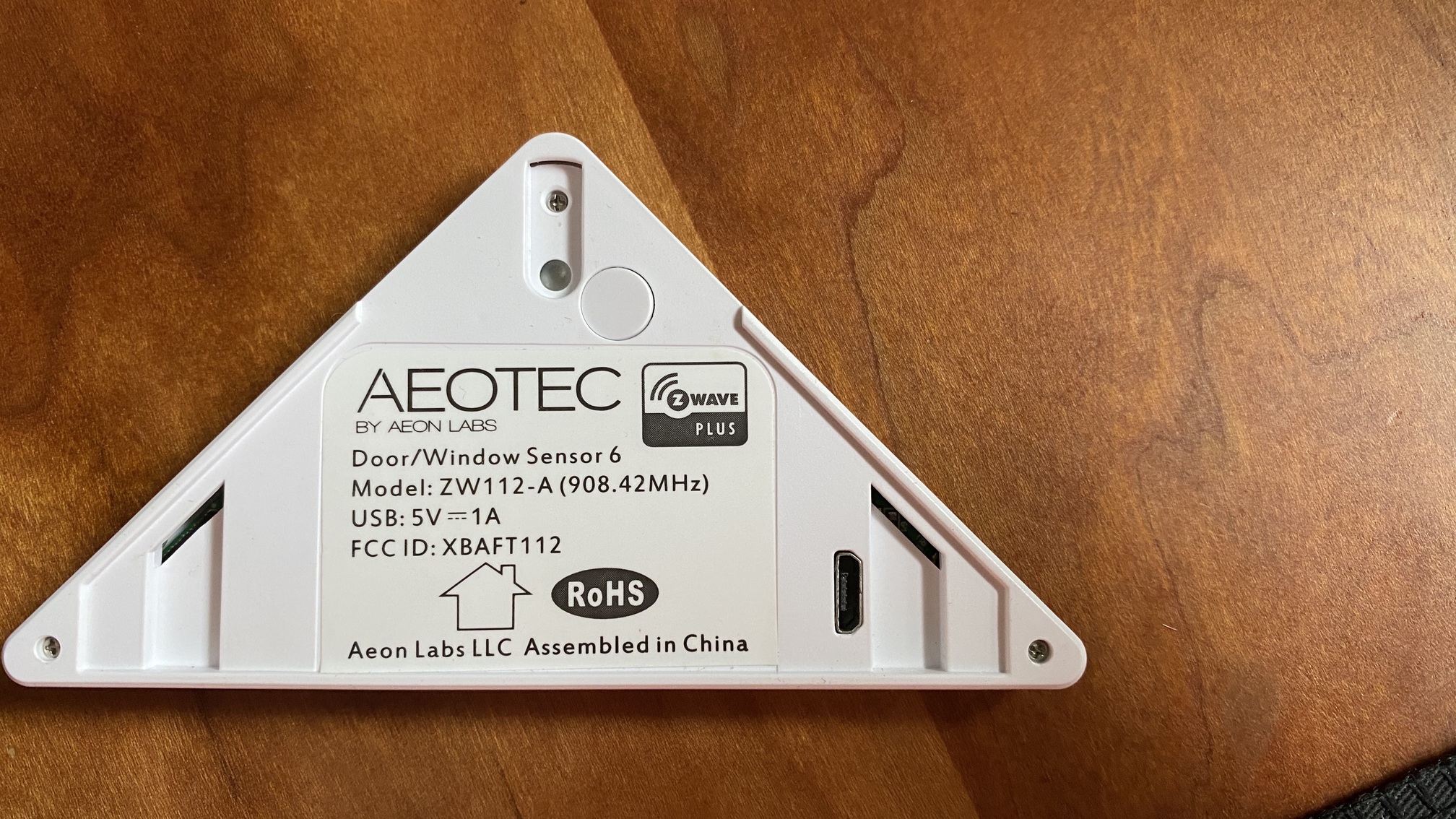

I am having trouble getting an Aeotec Window Sensor 6 to pair and show a status (open/Close) It shows the battery level. I have others that work correctly but not this one.
I joined it several times, did factory resets no open/closed. I rejoined it to my ST and it showed open closed. I am running a C7 V 142. Any ideas, other than the trash....

It's definitely a 6...

Sure the battery is good? Have you tried powering it from the USB port and near the Hub?
Are you using the latest Platform?? Because the Aeon Recessed Door Sensor had the identical problem, fixed in .142
I have the Recessed ones and was able to assist in that.. I don't have these. If you're joining it and using the Generic Zwave Contact Sensor, you should verify you're on the release that has the fix.
