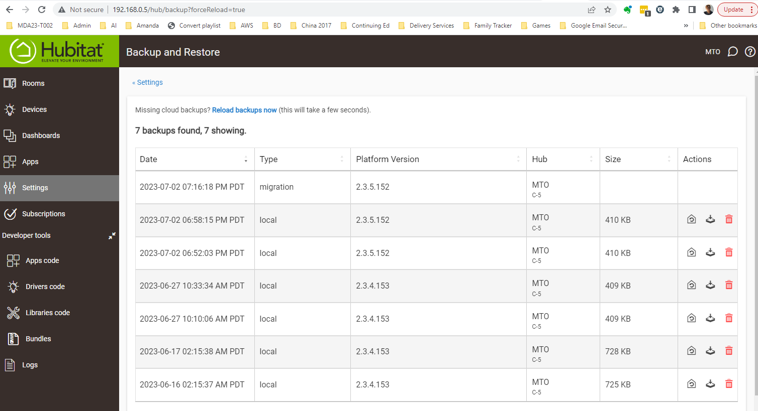

  1. Performed migration backup from C-5 hub.
  2. Confirmed migration backup in C-5 backups list

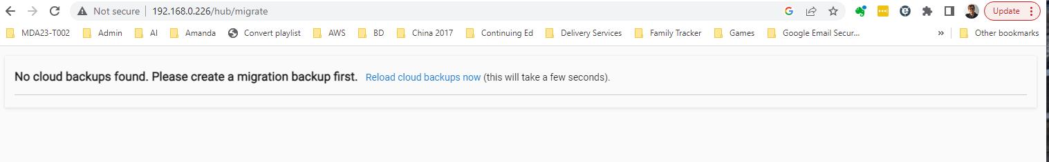

  3. Shut down and unplugged C-5 hub.

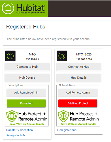

  6. Subscribed to cloud backups...created a C-5 cloud backup but I do not see it in the list.

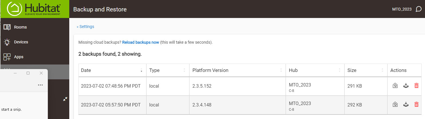

Does Reload backups now option on the C8 show cloud backups? If not, can you try rebooting the hub?

PS: I tried a soft reset on my new C-8 hub twice...also registered/degistered/registered with the same result.

I note that, even with the cloud subscription, I am not seeing cloud backups on the C-5 hub. the "migration" backup appears, but none of my attempted cloud backups.

(a) Even though the C-5 hub was showing a "migration" cloud dataset, it was not enumerated at the Hubitat host. Since no cloud backups were completing, these were not visible on the hub.
(b) Using a cloud subscription was helpful in diagnosing the issue. Without it, I would not have known the migration cloud backups were failing, as they did not appear in the hub backup list.
