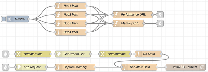

Sure please keep in mind that I have 4 hubs that I monitor so everyone's setup will vary. The original flow and idea came from the performance monitor example flows from this community. Those examples use the Apps list to which I found to be an apples to orange comparison because app installs vary greatly on my hubs so I changed it the events list instead. I added the memory query as part of that flow.
Performance Flow Export

Hope so. In any case my hub has been running fine since the rollback.
