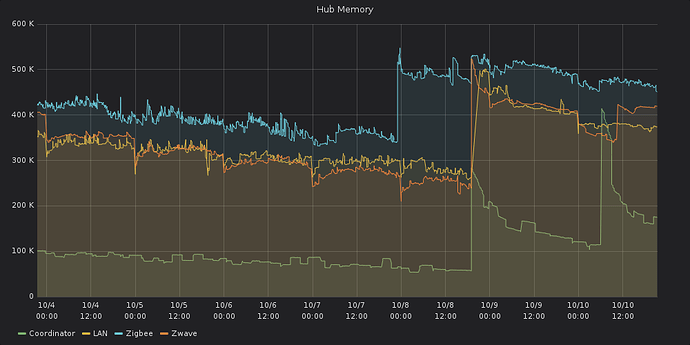

My hub is a C4. Anyone setup node red to retrieve the free memory from the hub for tracking over time yet?

Yes I added this to my performance monitor flow where I also capture memory on each of my 4 production hubs. As you can see I have had to reboot the hub especially the coordinator a few times in the last week because of slowness. Coordinator is a C5 and rest are C4s. All mounted vertically on the wall.
You mind sharing your node-red flow for the memory monitor?
