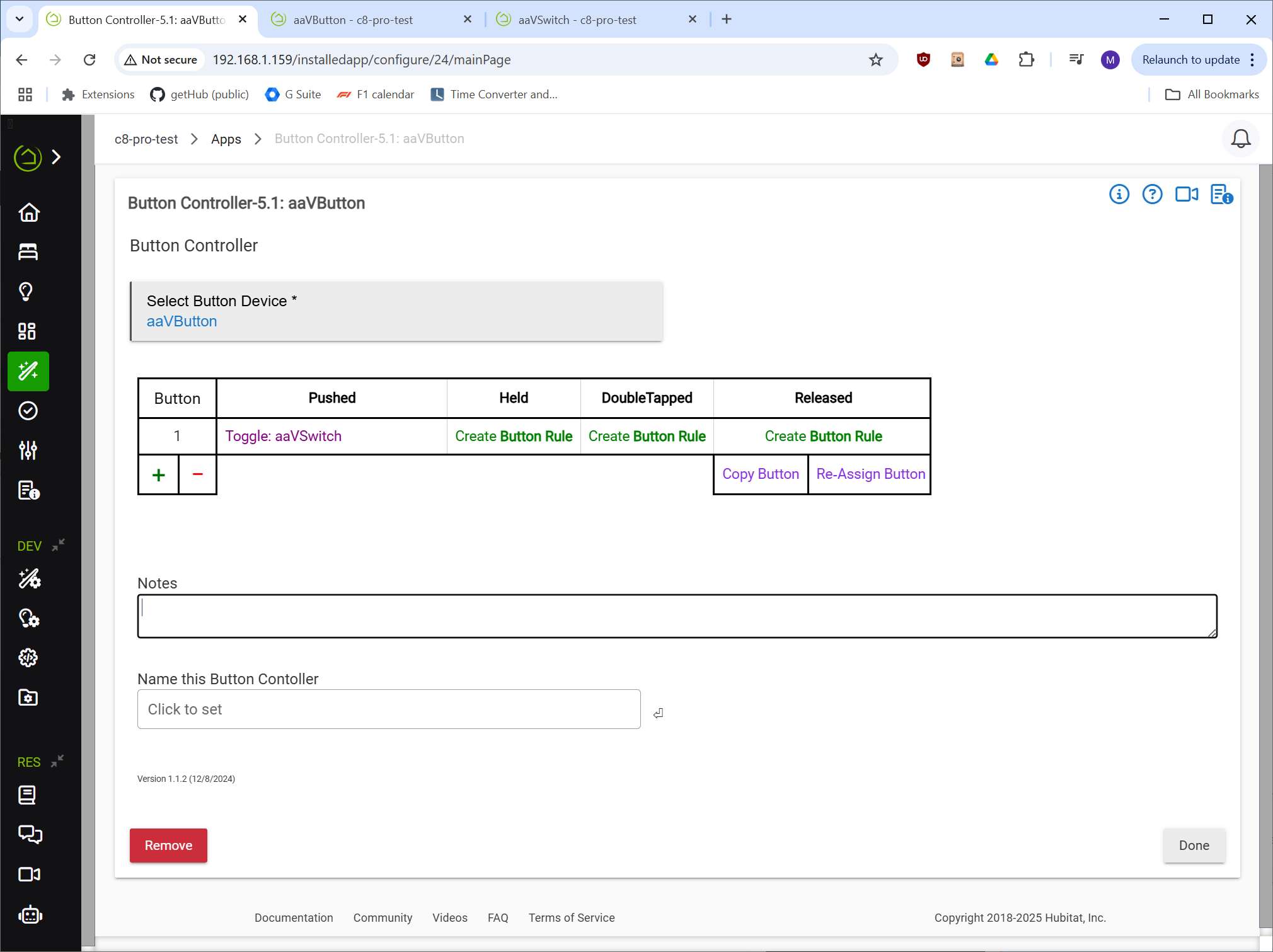

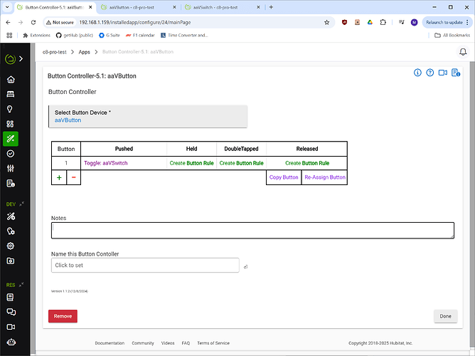

I just tested this and it works as expected:

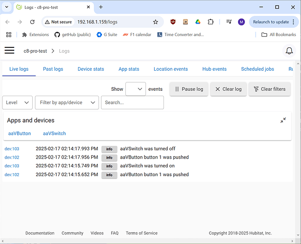

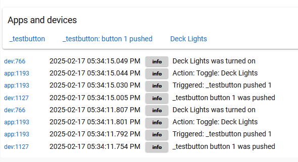

Here's the live logs of pressing virtual button 1, twice.

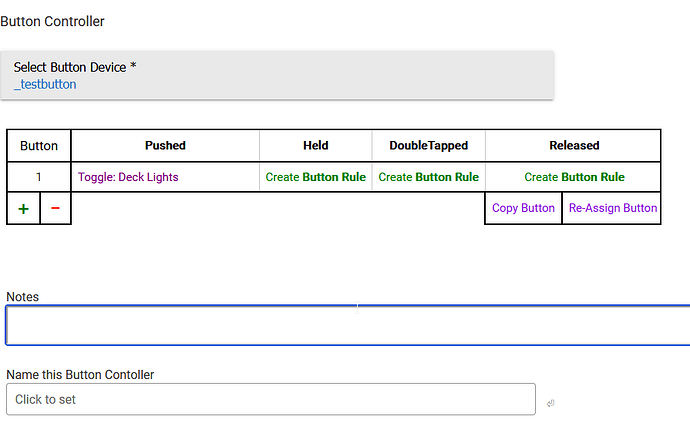

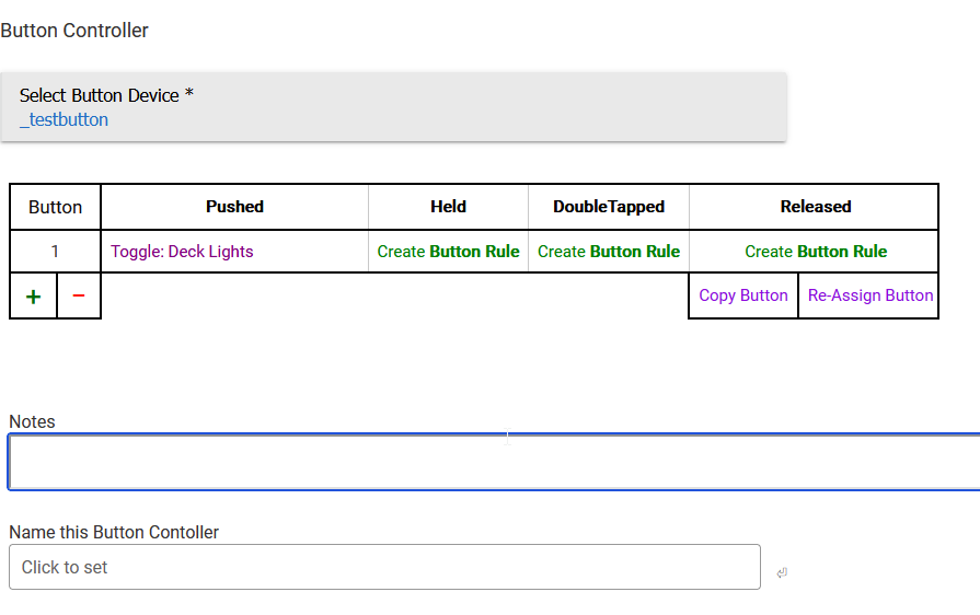

And the button controller rule:

Looks like you're well on your way with those fine logs, as directed, lol.
Just tried duplicating but it acts as it should.
