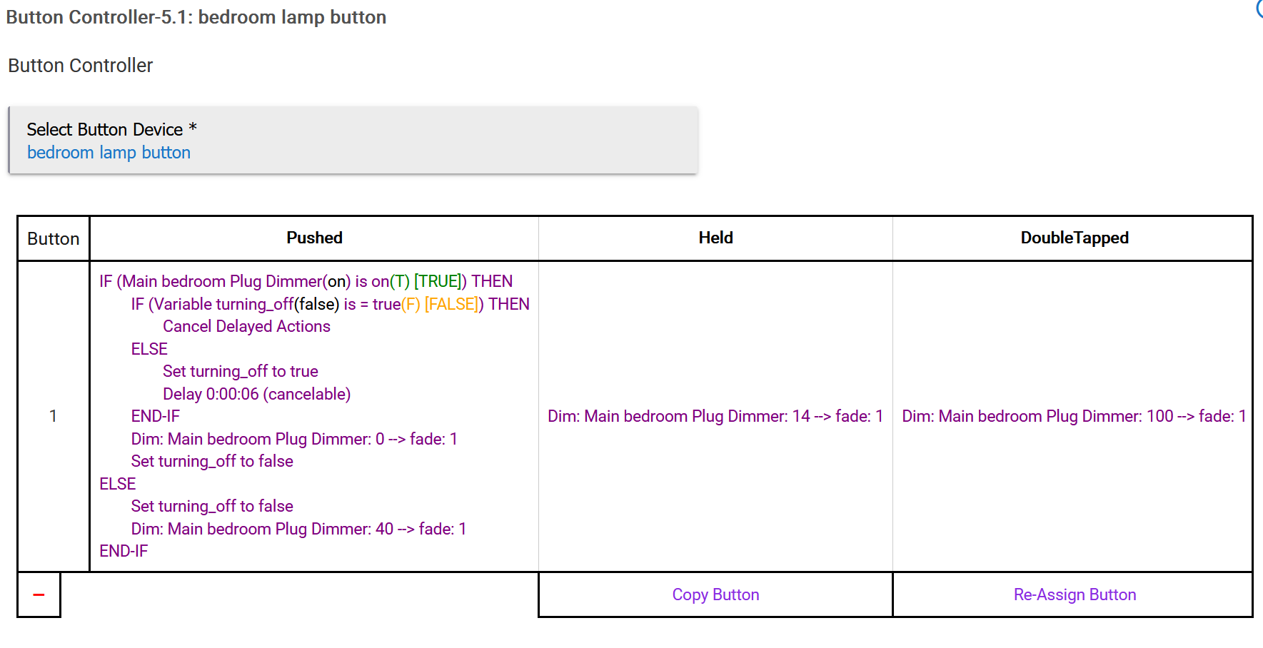

Building on @hydro311’s suggestion, here is an example of a Button Controller that should work as desired.
Might want to make the delay cancellable and cancel delayed actions when the rule is activated. Otherwise, you may get the light turned off if you decide to turn it back on after turning it off. Please correct me if I’m wrong.

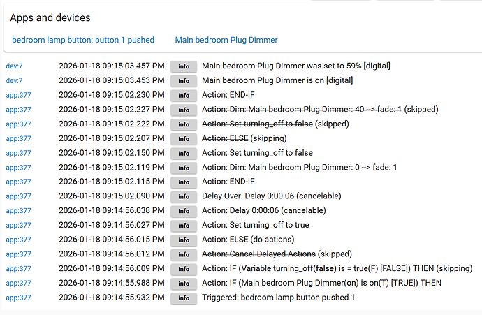

Here is what I have, and it seemed to be working, but today, the logs are showing 'odd' behavior.
If I only single push, toggle on/off, it behaves, with delay, with cancelled delay.

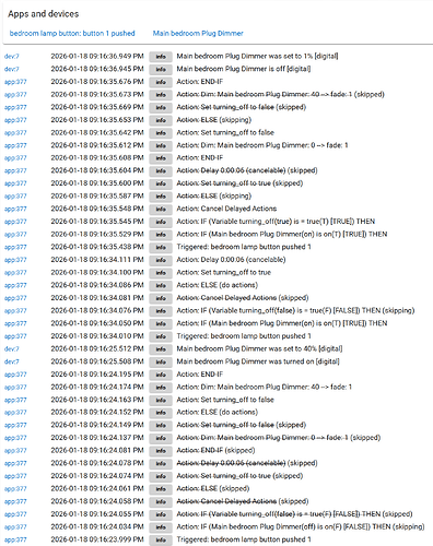

But if I double-click to get it to 100%, a toggle off toggles it off, then when it is done, the logs show it as 'on' even though it is not on at the physical bulb. Then after that, it takes a couple single click toggles to bring it back in line.
Any thoughts?

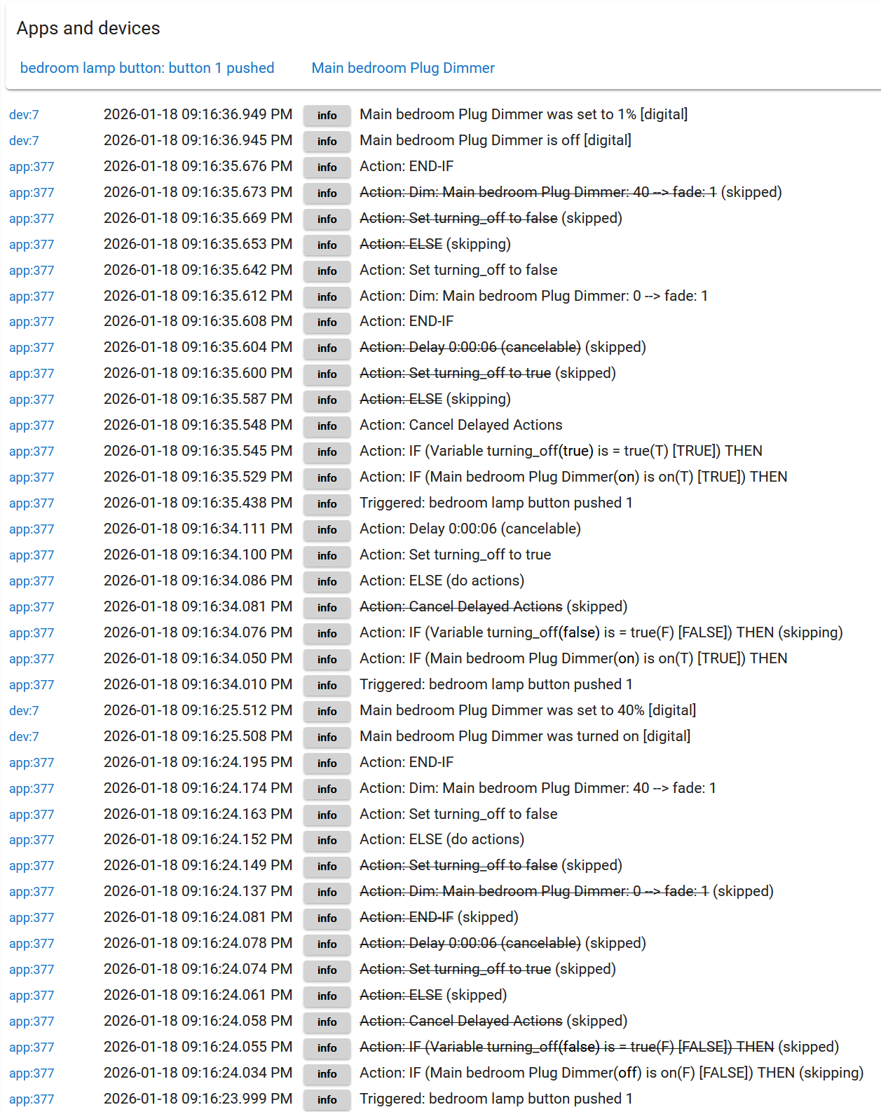

Logs of toggle off after a single press toggle on.
Logs of toggle off after a double tap to 100%
As a reference, here is a toggle on followed by a double toggle off, to cancel the timer and turn it off immediately.
Not sure why the middle case is internally turning the state 'on' when the lamp is clearly off.
If there is something that catches your eye immediately, thanks, but don't spend to much time. I am going to dig around some more. I swear that two days ago it 'just worked' then yesterday it got weird.
Hmmmm. I think it has to do with 'fading' down instead of just turning off.
If I dim it down to 14, then the weird behavior does not happen, but fading down from 100% seems to ramp so slowly that the script actually exits before the dimming completes, and the status comes back as 'on' even though the bulb has dimmed to off.
So it is a sort of race condition between the script actually exiting, and the bulb completely dimming.

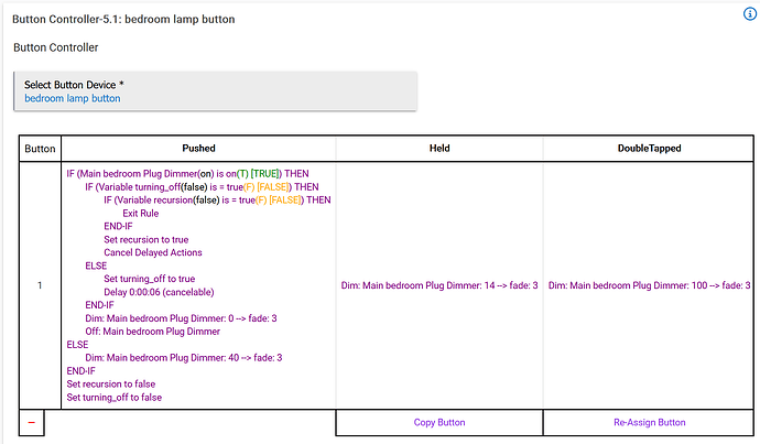

Jeff, thanks for your input, this is my final setup, which is doing what I want.
The recursion issue is such that I can 'slow double click' to avoid the six second timeout on the 'off'. If I accidentally 'triple' the third one is ignored.
I had to add sufficient fade delays to make it stable. I was hoping to use 'wait until dimmer_level <= value' tests to avoid having fixed delays, but wait for expression does not behave the way I expect it to, and I need to work on that a little.
Thanks again.
NOTE: The 'held' and 'double tap' just force the dimmer to a fixed value despite its current state.
