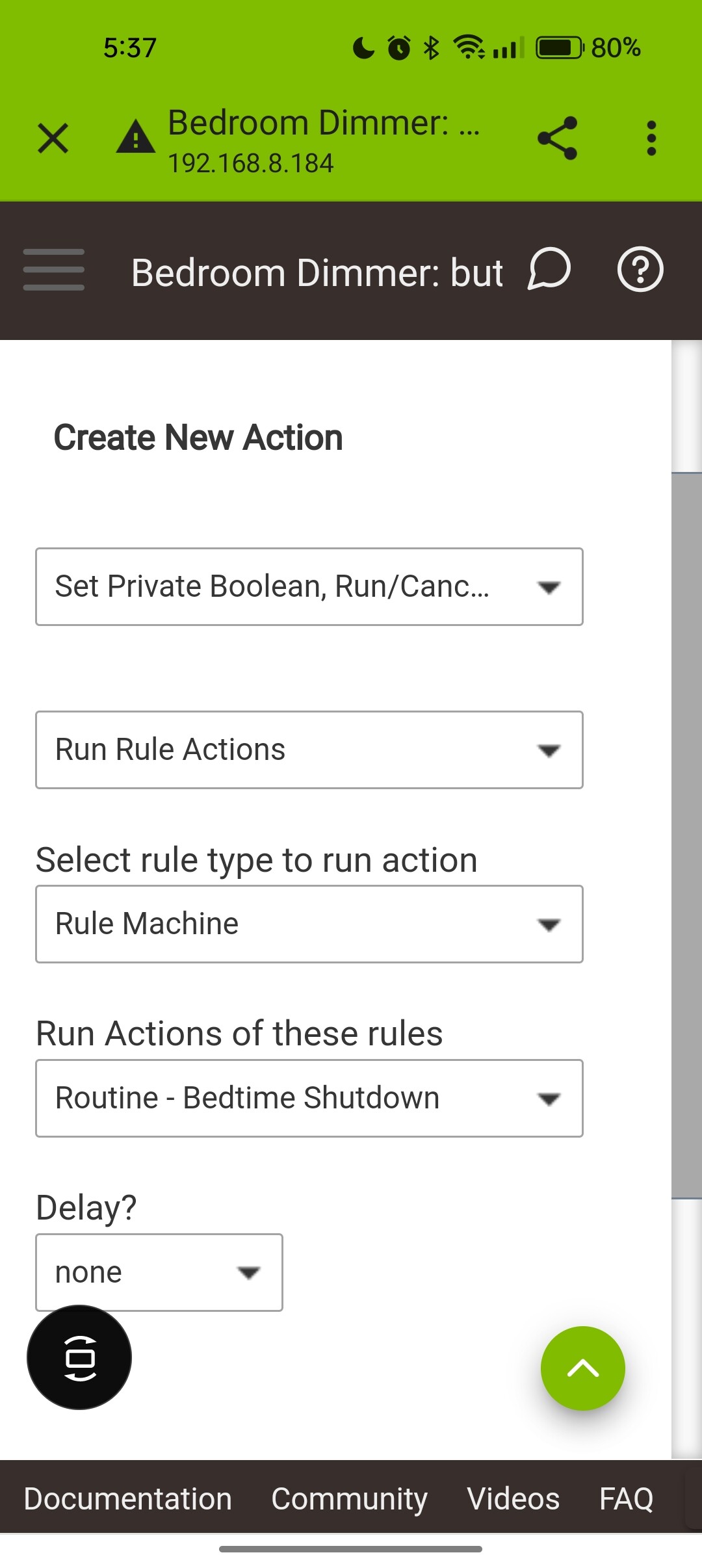

On the Create New Action dropdown it is the 8th option... Set Private Boolean, Run/Cancel/Pause Rules. From there you can choose to run either Button Controller or Rule Machine rules.
I discovered the problem, I think. Apparently my button controller rule, which was created a few years back, was created with an older version of button controller that did not have the option of Set Private Boolean … Run Rule Actions.
Here’s my old button controller rule:
I just created a new rule using the current button controller app, and the option is there!
Thanks, @Grizzlebeard!
