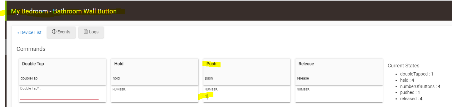

See below screen shot of the entire button app interface but I just can't find an option to enable loggging? Please can you advise?

No, Bruce, the screen shots are from the button rule as you requested and I have already enabled logs for button one which don't seem to apply to Actions but Conditions only.
Step 4 - Pushed button 1 on the actual remote and checked logs however there is only 'info' log rather than Triggers and Actions as per previous screen shot.
We are completely talking past each other here. You're posting a lot of screenshots, but not what I need to see.
Specifically, when you have the Button Rule open (Main Bathroom - Wall Button: button 1 pushed --what you show in step 3), click on the gear icon upper right corner, and show the Event Subscriptions on the page that comes up.
All of the logs you have shown have been for the device -- you have filtered for the device, so you can't see for the Button Rule. It will show app:xxx on the left, not dev:xxx. Depending on the Event Subscriptions, there might not be any logs, but I can't tell. Don't show any device logs, they aren't relevant to finding out what is going on.
