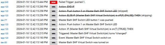

It gets to the Button 5.1 rule for that button (1) but nothing happens, the log emits
[Error] Failed trigger: push 1
I assumed the button controller sub rules are triggered by the button press. What am I missing?
Here's the log snippet
A failed trigger

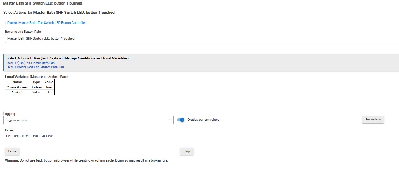

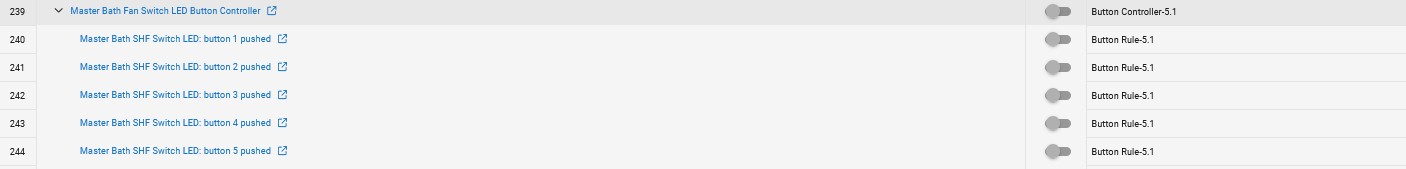

This is the button controller: app is 239, button rule is 240

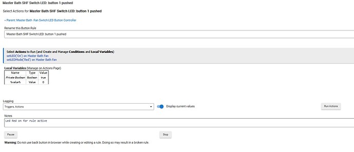

This is the Button 5.1 sub rule for button 1 (240)
Ugh, the perils of late night Rule Machining. I did led commands in dyslexic. setLEDMode is for on/off. and setLED is for color. I reversed the commands and it works.
