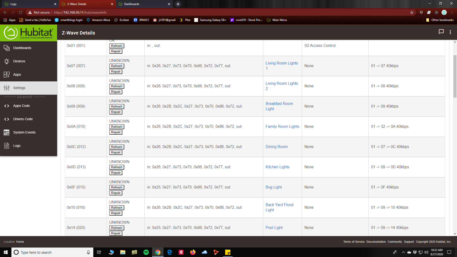

Nothing is working . Here's a shot of my devices. They are all unkown.

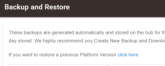

If you installed it at some point it's already on your hub, as I understand it. I had installed .119, and rolled back via below. I don't know if all versions are there if you skipped one and didn't install it.
On the Backup and Restore page...click on the "click here" link in the "If you want to restore..." line.
