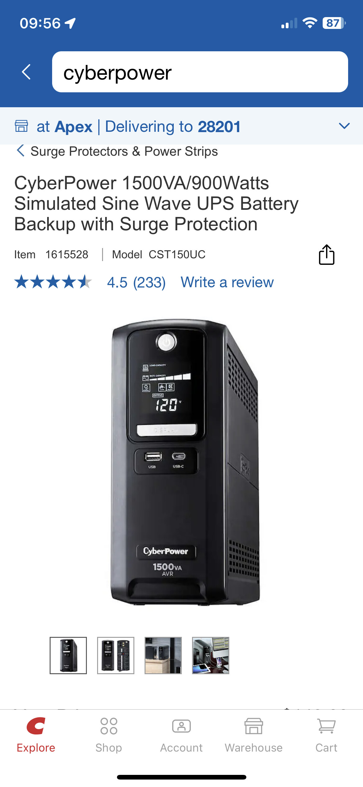

I have my Linksys router, AT&T gateway, network switch, and 3 hubs connected to it. It keeps everything running smoothly for at least several hours during power outages. I also have a smaller backup power supply in the garage where the fiber comes in. I have been using them for a few years now without issues. The simulated sine wave hasn’t caused any problems.
