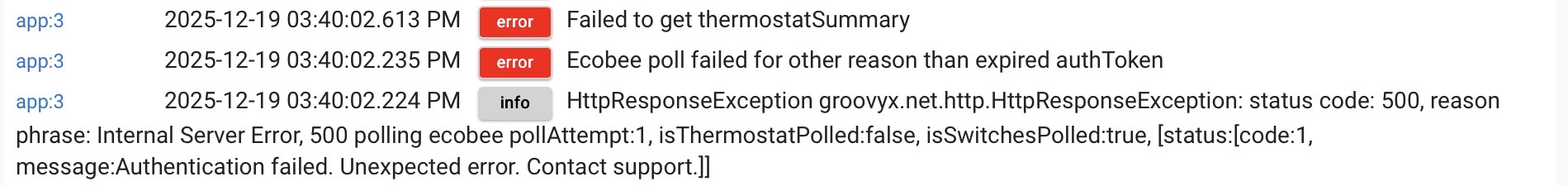

What I see in the logs for every poll attempt:

2025-12-19 10:10:01.066 PM info HttpResponseException groovyx.net.http.HttpResponseException: status code: 500, reason phrase: Internal Server Error, 500 polling ecobee pollAttempt:1, isThermostatPolled:false, isSwitchesPolled:true, [status:[code:1, message:Authentication failed. Unexpected error. Contact support.]]
Looks like beestat users saw something simular. It’s been fixed on the beestat side and in monitoring. part of the fix was to refresh the auth token on status code 1 and 14 and my logs i’m seeing both status codes.

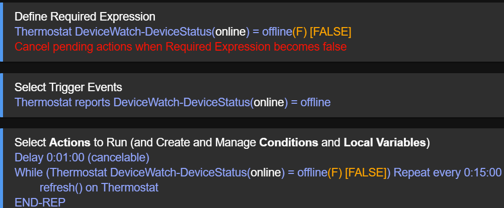

Executing command "Refresh" on the Ecobee Thermostadt device put the device back online the last two times it went offline.
I just created a rule to perform a refresh every 30 minutes. Hopefully that will keep things running until this is resolved.

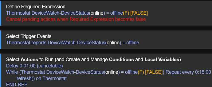

My take for an Ecobee Refresh Rule
