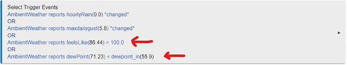

Here is the issue: I have created a rule that polls a device (Ambient Weather) and gathers some info from the device, then stores that info and takes certain actions based on that info. All the actions work as they should. The problem comes with the triggers. The rule has 4 triggers, two of which work fine (from what I can tell) and 2 triggers fire off every time the device updates (every 5 minutes), even if they should not. See the screenshot below.
As you can see, the triggers (marked by red arrows) should not fire. However, every 5 minutes, when the device refreshes, both triggers fire. See the log below.

I had the rules off for several hours. Turned them back on after writing the post above. As you see in the logs below, they ran without any triggers (false or otherwise) for almost 30 mins. Then, at 2:39, both rules were triggered twice each. One trigger is correct ("feelsLike > 100), but the other trigger fired off as well. So, instead of each rule running once, each rule ran twice.

The "false" triggers are coming from the first two triggers in the list above (in the original post), which are "changed" triggers. One of those triggers "maxdailygust" is showing in the event subscription below. When I remove those triggers, the rule does not trigger (the "events" still show up in the log). But when I put those triggers back (either one or both), the rule is triggered and runs a duplicate. I have found that one of those triggers causes a false trigger every 5 minutes, and the other one causes a trigger every 10 minutes. So I have to believe that the device is updating those attributes in some way that makes it trip the "changed" trigger.
