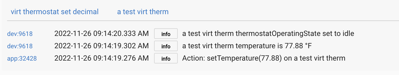

You have to provide a lot more information to tell what's going on. Here is a rule that works fine "stuffing a float/decimal down its throat with a setTemperature() call":
Logs:

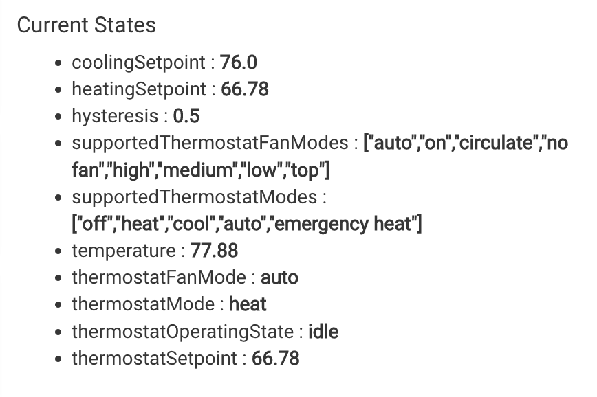

And the resulting device state (note temperature):
