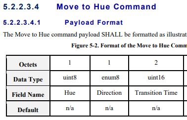

According to Zigbee specs, there should be 3 fields in a "Move to Hue" command. But the setHue method misses the middle "Direction" field. For example, setHue(50) generates this command:
[he cmd 0x33BB 0x01 0x0300 0x00 {7F 1000}, delay 2000]
But it should rather look like...
[he cmd 0x33BB 0x01 0x0300 0x00 {7F 00 1000}, delay 2000]
Direction is optional apparently or the command wouldn't work at all, and it obviously does.
According to the specs, it is required. And I've tested it with a Sengled bulb: it doesn't work using the zigbee.setHue method. But it works if I add the missing field using the generic zigbee.command method.

Yes, there is indeed the mentioned bug in the zigbee.setHue method.
We'll get this fixed in one way or another.
